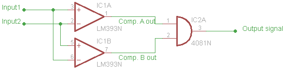

I'm not entirely sure about this one, but it's an idea:
When two halves of a 393 comparator chip are wired together with the inputs swapped, it has two separate outputs. When one input is higher than the other, one of the outputs goes high and the other goes low. If the opposite input is higher, the opposite output goes high and the other low (sorry if this is really confusing--read through it a couple of times and you'll probably get it ;) ). However, the chip can not read exactly which input is higher--it must differ by a certain voltage. Therefore, there is one point where both outputs are high (when inputs are extremely close to being equal). If you connect both outputs of the 393 to some sort of AND gate, the output of the circuit will only be high when both inputs to the comparator are very close to equal.
This is all in theory, of course, so if anyone could please let me know if something about this is wrong, it would be a great help ;)
Good luck!
Der Strom
Strom, I wouldn't rely on the intrinsic offset of a comparator to define the width of the window, which is what you're advocating.
Thanks, Mike. I understand what you mean. I'm sure there are better ways, but depending on the OPs project, it might still work. As I said, it was just an idea, and if EfeVural feels there is a better idea presented, by all means use it :) I am not saying mine is the best idea, but it certainly is the simplest yet ;)

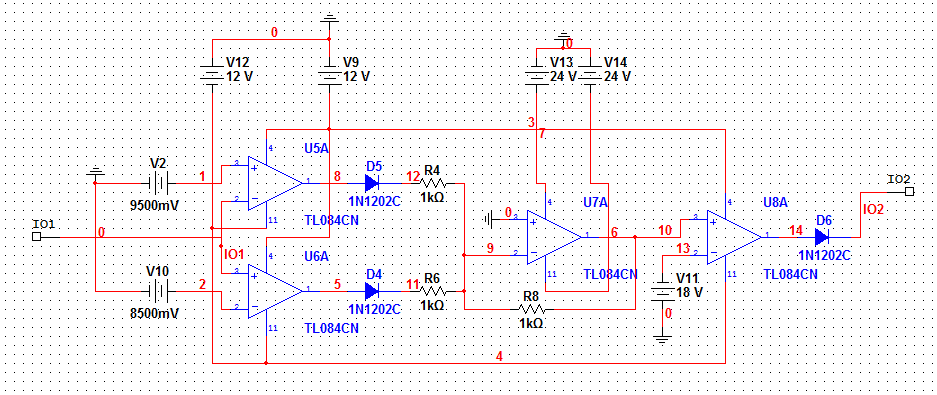

Thanks for all of your answers. I found a way. I am not sure if i used i window comparator but i think at least it is something like that.
Here is how i did it: I am putting the input voltage between a window comparatar. Let say if my imput voltage is 12, then high ref=12.5 low ref=11.5. Then i put the output voltages of my window comparators to a summing amplifier. Then the output voltage gives +2VCC if input is between referance voltages. If it exceeds referances beyond either low or high; then output gives 1VCC. Then i put this voltage as an input voltage to a comparater using a referance voltafe between 1VCC and 2VCC. If it is 2VCC so bigger than ref voltage it gives an output..
