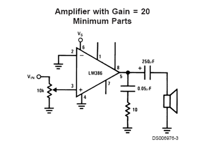

Attached is the schematic of LM386 with a gain of 20 (taken from datasheet).
Lets say if I use that circuit with Vs of 5V, if I connect the output of RC lowpass filter to Vin (Vpk-pk of 4V), won't the output of the audio amplifier be 5V for most of the time because of the gain factor of 20..? I mean, It won't be able to amplify the voltage any further than 5V right..?
Sorry, I don't quite understand.. What is the advantage of using the audio amplifier..?
Another question is what is the purpose of the 10K potentiometer at Vin (in the schematic)..? Is it to bias the Vin so that it is Vs/2..?

You need a power amplifier to drive the 8 ohm speaker or drive the 32 ohm headset.
The datasheet for the LM386 shows that its output power into an 8 ohm speaker at clipping is only 0.113W which is very low but will be loud in the headphones. The tiny speaker has poor sensitivity and poor low frequency response. Cutting high frequencies above only 2kHz will sound horrible.

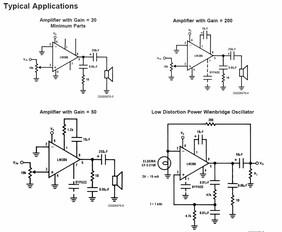

Attached is a part of the datasheet that shows 3 circuits with different gain (20, 200 and 50).
In the datasheet, it shows that the gain for 1kHz is between 26dB to 46dB (approx 20 to 200 gain).
What I don't really understand is how can an input of 4V (output from lowpass filter) experience such a high voltage gain when the Vs is only 5V and not 80V or higher (20 gain x 4V = 80V). I don't really understand the concept..
Can you please explain.. Thanks..
Your input to the LM386 has a max of 4V p-p and the max output from an LM386 into a speaker is only 3V p-p. So connect the LM386 with a gain of 20 and turn down the volume control.

I'm wondering.. if I use the 20 gain circuit but I turn down the volume control, then, the purpose of using the power amplifier is not really to amplify voltage right..? It is more for impedance matching is it..?. So that more current can pass to the headphone..?

Umm.. I mean.. I still don't really understand why we need to decrease the output of the lowpass filter from 4 Vpk-pk to around 0.15V pk-pk so that it is able to be amplified by a gain of 20 to cause an output voltage of 3V pk-pk (Vs = 5V). Isn't that an attenuation of -0.75 (3V/4V) because the output voltage is lower than the input voltage? How does it help in amplifying the sound and make it louder..?
I am abit lost there.. Can you please explain.. Thanks..
Yes, the purpose of the power amplifier is to supply the relatively large current needed by the 8 ohm speaker which the PIC's output can't provide. It's a power amplifier, not necessarily a voltage amplifier.
