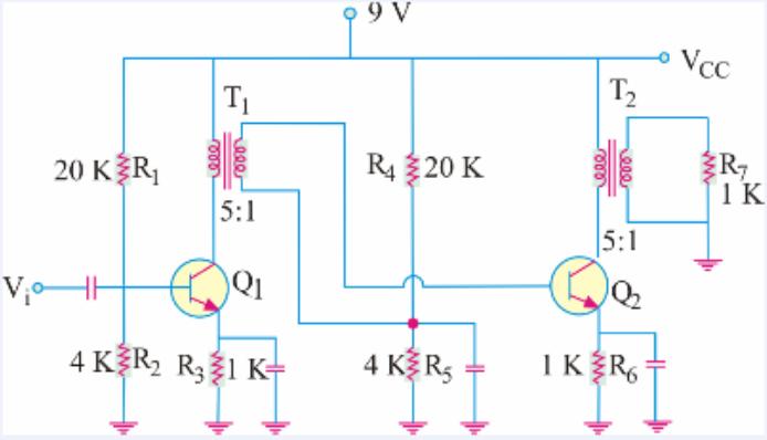

i would like to construct an experiment on coupling two stages of Common emitter amplifier by using transformer coupled method. But i dont know which ratio to choose or how many resistance for the primary and secondary winding.
I get the idea from here.
Anyone have any idea on how to calculate what is the spec i need to buy for this circuit? How is the calculation? After some calculation i get Zin for the 2nd stage is 1.06kohm (correct me if i'm wrong). then how about the Zout for the 1st stage?

i do this because it is consider a basic learning on understanding different type of coupling for multistage amplifier and it is an assignment for my school. so i have to find out the calculations and prove it with the practical part.

Since you have bypass caps on emitter resistor the input impedance on common emitter BJT is roughly (beta +1) x (0.026/Ie).
Your two stages have Ie of about 0.9 mA. Assuming an AC beta of 75 then input Z is 2200 ohms.
If your transformers are 5:1 turns ratio then the collector load is about N^2 x 2.2k or 55k ohms on first stage, 25k ohms on second stage.
The 5:1 might be impedance ratio, depends on how transformer is spec'd.
The gain will be very high, probably overdriving second stage.
