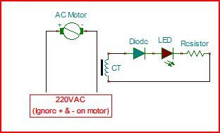

A current transformer (CT), diode, resistor and LED circuit. A ct like this: **broken link removed**
What HP is the pump? Or, what is the current (I) listed on the motor? That will determine the proper CT to use.
I'll post an example schematic shortly.
Thanks cowboybob. Is transformer really necessary? Can the schematics be just connected in parallel to the pump's circuit?
Yes. But I wouldn't recommend it. All that tells you is that the pump is powered, not the the pump to actually pumping, i.e., drawing current.

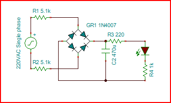

This ckt will do as you ask, i.e., transformerless (although only indicating power to pump is ON).
The circuit posted previously did not work. My apologies - I got it off another site and when simmed, it failed. See below.
But, again, dangerous voltage levels are present with the circuit.
OK, thanks. What would be the value of the resistor? According to my basic understanding of Ohm's law is it 1.1 kom given that LED current is 20 mA ?
BTW, Welcomw to ETO, ggv!
I removed the first schematic. See above.
New circuit (this simmed just fine):
NOTE: R1 & R2 should be 1W resistors.
In this circuit, LED current is about 5.7mA. R3 and R4 can be adjusted to suit the needs of the LED you choose to use.
And I repeat: This circuit poses a severe electrical shock hazard!! Take all appropriate safety measures.
R3 and R4 are in series and can be replaced by one resistor.

Is rectifier bridge really necessary? Do you think LED will flicker if it takes every second AC pulse ?
The bridge is used to isolate, as much as possible, the 220VAC from the LED side of the circuit. A single diode does not isolate the 220VAC at all.
