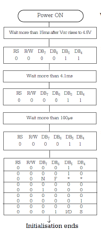

Edit, the initialization routine can't write commands until it has written several nibbles.
Here's the initialization sequence, note the first 3 writes are nibbles only.
