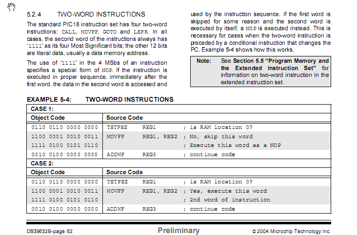

This may help till Mike comes back online.:)
Look at the Program Cycles in the datasheet.
