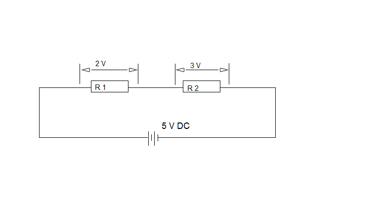

can anybody tell me how to calculate resistance required R1 an R2 to generate below mentioned voltages,
how do you calculate it ?

Make it easy for yourself by choosing resistors that add up to 5k Ohms. R1+R2=5000.
Calculate the current around the circuit using Ohms law. I = V/R. 0.001 Amps (1 milliamp).
So I is 0.001. Now use Ohms law again. R=V/I. to calculate the two resistances.
There are quicker formulae to get the result, Google voltage divider, but the long way gives better understanding.

What do you have here ? The V0= 5volts. V1=2 volts. V2=3volts. V0=V1+V2. Anyway :
V1=R1.I ... 1
V2=R2.I ... 2
Either:
a- You got V1 so you SET arbitrarly R1 (to a normalized value if it's a board you entend to really make), you could then get the I, inject it in 2 and get R2.
(Same thing can be used in 2, you set R2, get I and inject it in 1)
b- You set arbitrarly I, and inject it in both 1 and 2 and get R1 and R2.
But the point being that, you always look at what you have, at the equations. V=Z.I here. It takes TWO to tango.

Give R1 any value you like and then R2 = (3*R1)/2

I have never chosen a specific current in a problem like the example voltage divider.. why would I do that? I usually want the current to be "low" and then I choose the other resistor from E24.. and then I calculate the value of the other resistor.
If I choose some fixed current to work with, then I can easily end up with two resistor values that are inconvenient in practice.

I said that I have never chosen a specific current (value) for a voltage divider. I never use current to calculate resistor values in a voltage divider. I do calculate the current after I have chosen the resistors, just to check if it's "low" enough.
For example, if I need a voltage divider that divides 5 volts in half, I would just put two 10k resistors in series and never calculate the current. And if you want to know why I chose 10k resistors.. It's because I have a s*it load of them in stock. Can't say that about 60.4 ohm and 100 ohm resistors.

If there is a load on the voltage divider output then you are changing the circuti resistance, thus you end up changing the voltage divider output.
