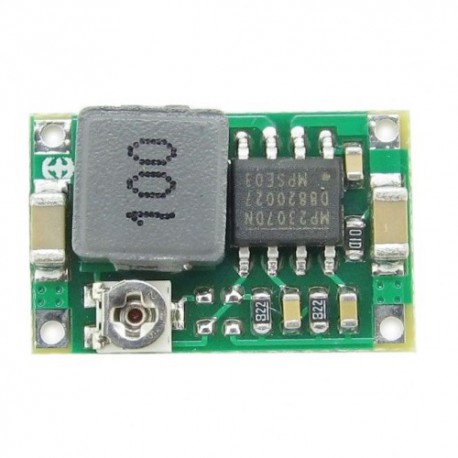

I attached an example of 1 of my projects. Now the problem i am having is, it is really hard to replace a single element if it goes bad. Imagine replacing the little step-down, i would need my equipment if i was to replace it at my friends place.
I am looking for a better way to design and make my little projects. It would be great if all my components, including ESP8266 could be simply swapped with a working part, using the little leg elements (in a similar way that you can replace a fan in a computer, simply unplug it, plug a different one in). Also all those wires are dead weight, it would be a lot easier if i had like a circuit board with all those connection and i would only solver the elements to the appropriate location. But i am wondering how much would a custom circuit board cost - would it make sense, since all other components you see are very cheap (probably everything on the image combined is around 10$ .. )

I figured most things, how to do it. 1 of the things that is still a problem is this small step-down i use in mostly any project. I would like it to be swappable without any soldering or wires. So my plan was to solder pins to step-down, 1 pin to each of the holes (pins fit into the holes nicely, the step down is the size of hand nail). Its easy to separate those pins on the bottom right picture so i get a single pin. But now i also need a female header that will be on the PCB itself. And here is the problem. I cant seem to find a single female header, the lowest i can find is 2 pin. When i look for single female header all i get is female dupont. But thats not what i need. I need exactly what u see on the middle image, but only a single one. That way it will be swappable, but without dupont wires, which tend to get unplugged

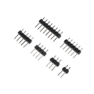

Are you making a pcb "mother board"? If so, I would lay it out for 2 pin female headers, and connect them in parallel or leave the extra pin unconnected. Header pins are square, so you need 2 pins to keep the connector aligned. I'd solder the female 2-pin sections to the mother board, put single pins where they are needed, then position the module on those pins and solder them in place so the alignment is correct.
A better but slightly more complicated option would be to design the motherboard to fit Mill-Max sockets for round pins, and use headers with round pins on your modules. Then there is no worry about keeping a square pin aligned with a square hole. They have many options for pcb sockets.
The middle picture was just an example. I am using headers that have same sides - doesn't matter how you connect them. I am adding another picture to make things clear. As for what i am doing, i included a picture of what im trying to do - but do it smarter, with less wires. Because those wires are just waiting to get unplugged.

The picture is and was perfectly clear. As I said, the posts are square. The fit into a socket designed for a square post.
If the pin and socket aren't aligned properly, the socket will not make proper contact with the post.
A pin oriented like this: <>
will not mate properly with a socket oriented thusly: □
Sorry the world won't conform to your vision.
Ah, i understand what u mean now. But it wont be hard to align those pins since they have a plastic square on them, im pretty sure i can get that square enough. But good call, will test asap and see if its doable or i will have to go the round pins way

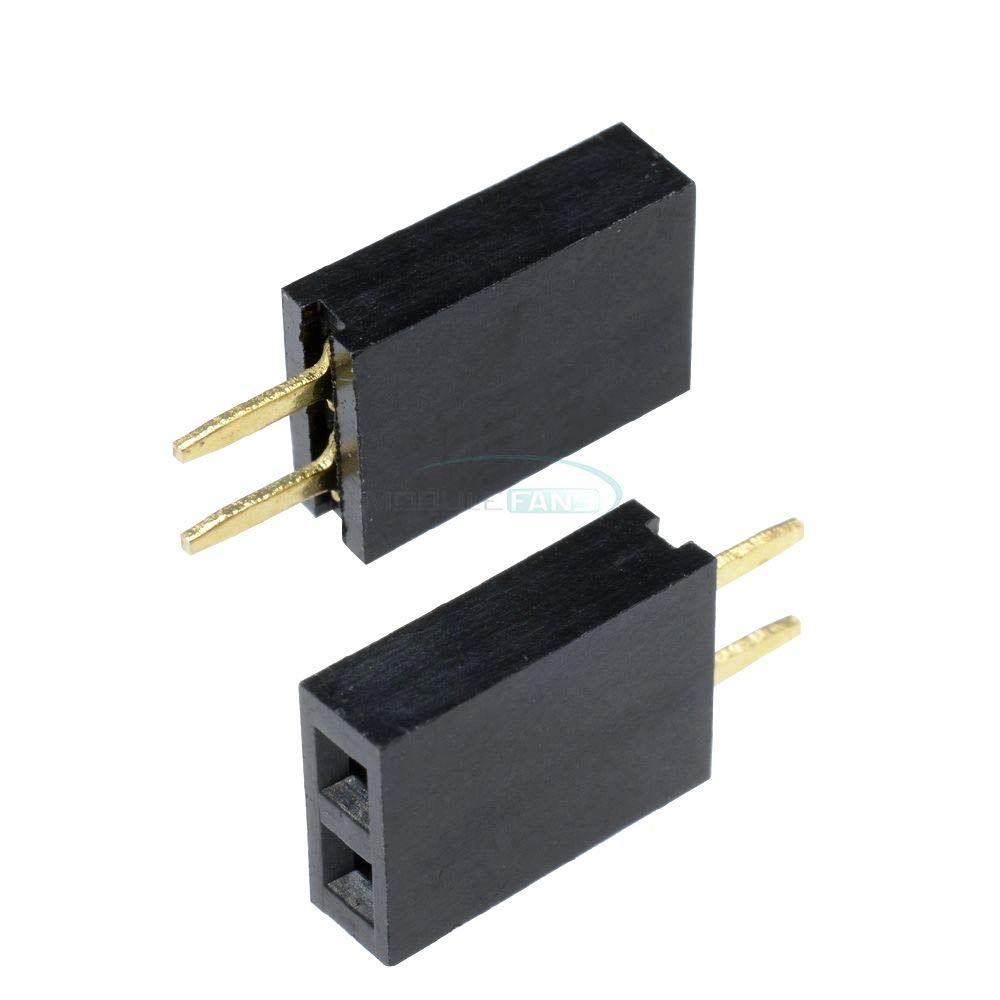

The contact in a female header is a thin metal fork as shown in the drawing below. It contacts a square post over a small contact area on opposite sides if the post is inserted squarely. If the post is rotated even a small amount, the already small contact area will be greatly reduced. The result will be an unreliable connection. That's the reason you can't buy a single position male or female header.
Dupont connectors are a different game. There, you have a square (pin or socket) on the end of a flexible wire plugging into a square (socket or pin) header on a circuit board. The pin and socket align because (at least) one of them is free to rotate into proper alignment.
