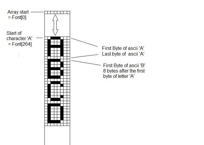

The way that this large lookup table works( because that's what it is really) is like this..
They are declared as such :-
unsigned char Font[] = {...... lots of bytes....};
Now lets assume each ASCII character is a small bitmap with 8 rows and 8 columns...
The font is like this
To calculate the offset we use ASCII table... The letter A is at position 65 in the table.. When making the bitmaps we are only concerned with the space character onwards.. The space character is in position 32 of the ASCII table..
There for that is where we start!! If Font[0] is the start of the space character, then we need to deduct 32 from the character (0x20 in hex)... Then as each character is 8 bytes we can find the start of character 'A' by using simple arithmetic.
65 (A) - 32 ( space ) * 8 = 264... Therefore bytes Font[264] to Font[272] contain the bitmap for A..

Now you say that you have done a counter using a 7 segment LCD / LED.... Using a matrix is no different.. In fact it is easier.... The only thing is timing.... You need to update the LED's..
4 digit counter using 7 segment LED..... update = 4 bytes... 4 cycles.
4 digit counter using 8x8 LED's ... update = 32 bytes... 32 cycles.
So instantly we see the update speed has dropped considerably... You will find that polling is just not fast enough! Sure just while displaying simple characters and numbers, the display will look reasonable, but as you increase process time for other things, it will start to get choppy.... Re-visit the code I did for you before... Using the timer interrupt!!
You can have it, I wrote it for you.. You could physically use a matrix of 16x32 using that code..
