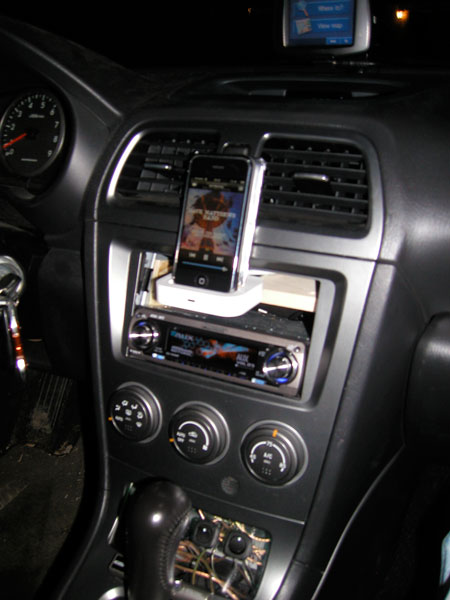

My scenario is this: I have created a mount for my iPhone in my car which sits just above the head unit (pic attached). When the iPhone uses GSM (for calling or texting) I get unbearable interference in my sound system (painful high-pitched buzzing). If I move the iPhone a couple feet away, the interference goes away. I have helped the situation by placing a sheet of aluminum foil behind the iPhone, but it hasn't completely fixed the issue. Any ideas on how to solve this problem would be appreciated.

Thanks for the reply.
It is not a factory system, though. Everything is aftermarket and installed by me: head unit, speakers, amps, all wiring.
I'm not saying my install is perfect but you really think the problem is in the wiring? It seems like the problem is an improperly shielded head unit because if I move the phone away from the head unit, the interference goes away, regardless of how close I move the phone to any of the speakers.

Ok, that makes sense. I think my head unit is actually shielded pretty well, and that shielding is tied to ground. There is no speaker wire running near the phone, just line-level RCAs (from the phone and output to the amplifier in the trunk). I don't think it'd be realistically possible for me to shield the entire length of wire, from the head unit to the trunk, but I will experiment with shielding near where the phone sits.
Anyone know if ferrite beads help with this kind of thing?
My head unit seems to be pretty well shielded and grounded. Also, there is no amplification happening at the head unit. I think it's a good possibility that the RCA connections are picking up the interference. It's going to be very hard to shield those RCAs, and I don't think I can shield them 100%, but I'll see what I can do.
Does anyone know if putting ferrite beads around those RCAs would help this problem?

I do believe it is my pre-amp RCAs that are acting as an antenna and picking up the interference. They then send the interference to the amplifier which boosts it, sends it to the speakers, and then it's audible. I don't think it's the head unit that's picking up the interference because the volume level of the GSM buzzing is the same no matter what volume position the head unit is at. And it's not the amplifier that's picking up the interference because it's out of range, all the way back in the trunk.
So I think I will focus on shielding the RCAs as much as possible and see if that has any effect of the interference.

I thought the interference was being picked up by the RCAs, however when I disconnect them from the head unit, the interference goes away. Using ferrite beads from RadioShack on the RCAs did not help the problem. I also tried wrapping the first few inches of RCA with aluminum foil, which didn't help, but I didn't give that one much effort. If I wrapped them with aluminum, I would then have to ground the aluminum, right?
The angle of the cell phone has a direct effect on the level of interference. If i hold it parallel to the head unit, the interference goes away almost completely.
I also notices that as a move the iPhone closer and closer to the dock, the interference gets higher and higher. Then, as soon as the iPhone touches the metal on the connector in the dock, the interference skyrockets. And then, when I slide the aluminum foil behind the iPhone, the interference goes away.
