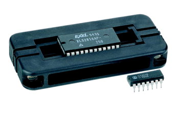

Actually the force needed is minimal and requires a subtle push. too much force and your leads go to far. The IC insertions tools are somewhat expensive and really not worth it. Here is a link to the type of tool I am talking about.
The tool that aligns DIP pins is quite simple. It is just a fixed block that sets the distance between rows of pins. On each side of it another block that pushes the pins against the first.
You could fake it with 3 blocks. The center one would have to be the right width. Press the chip onto the first block and hold in place. Then press the other two block onto the pin to align them.
EDIT: This is one of the tools that you can do without. But once you have it you will find yourself using it because it does a good job and is quick, easy.

There is a useful tool called "Pin-Ausrichter".
It's usable for standard IC with pins rows spaced 7.62mm and double spaced rows of 15.24mm spacing.
It is very helpful if you grab an IC out of the junkbox and want to reuse it. The pins are also out of alignment after pulling an IC off the socket sometimes.
Normally those pins are bent in any direction and bending them on a table top won't take care of those bent inside.
To treat such an IC just bend all pins outside at only approaximate angles. Then insert into the Pin-Ausrichter and press the outer grip firmly. All pins will be more or less angled 90 degress depending on the pressure you apply.
The tool is available at https://www.conrad.de. Order number is 168203-62, priced EURO 6.10 (including sales tax)

That is the same tool I have. It aligns the pins in a row but does not adjust the spacing between adjacent pins. Still very handy to have. You can easily live without one but it is a useful tool.
Yep, that looks like a lot more fun than the needle-nose-pliers-and-swearing method I usually use when the pins are really bent up. :)

Use this tool in combination with an IC-inserter. That way you won't have to bend the pins at a 90 degree angle (little pressure only), use the IC-inserter and "plug" the IC into the socket.
The tension will hold an IC even under high g-loads.
