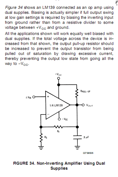

Hi! I am trying to amplify a 3-3.5V PWM signal to a 5V PWM signal, frequency may range from 500Hz to 5kHz. I created a schematic in simetrix using a non-inverting op-amp(LM139), the figure is shown below. Although I managed to create a PWM signal with 5V amplitude, the frequency somehow became 10kHz (from 1 kHz) and there is a triangular wave form in the Voff part of the PWM. Can you please tell me the problem here, or if there are any other ways to amplify a PWM signal more efficiently? Thanks very much! :)
hi
A LM139 is an open collector output, it needs a pull resistor to +V
BTW: its a comparator IC not a true OPA
EDIT:
A circuit for a dual supply amp, the bandwidth is VERY limited.

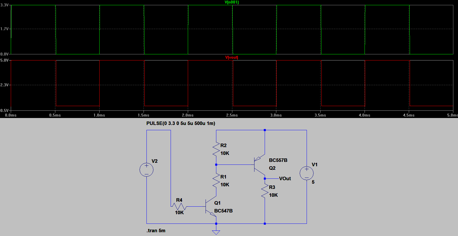

AMPLIFYING A DIGITAL SIGNAL
A Digital signal is only detected as a HIGH or LOW. However if the digital signal does not have sufficient amplitude, it may not be detected AT ALL.
This circuit detects a low amplitude signal and produces a high-amplitude signal.
You want to use the circuit Colin provided. If you run a simulation on it you should get the attached image. The upper trace is your pulses in and the lower pulses out. Using two transistors maintains the phase relationship.
Ron

Hi! Thank you very much for your replies!
I tried using colin55's suggestion and created a schematic similar to it and the output waveform turned out to be what I needed (schematic and waveform below). Instead of using BC557 (PNP), I used BC857 and instead of BC547, I used BC847 due to parts availability in the local store. I was thinking that this could be the best way since if I use amplifiers, I need to obtain the correct part that is fast enough to process PWM signals. I just want to ask if I use transistors for this, do I still need to consider if these are fast enough to process PWM signals?
Again, thank you very much for all your suggestions and help!

Your PWM modulation (audio?) is 50hz to 5kHz, not the switching carrier. The switching carrier is at least 50kHz or more.
Your resistor values are very high so the capacitance of the transistors and the wiring will produce lowpass filters and mess up ultrasonic pulses.
Similarily, a breadboard cannot be used for high frequencies because of its high capacitance between wires and contact strips.
I used a carrier of 2kHz for the PWM switching carrier on an electric RC airplane motor speed control and it worked well but was very loud.
