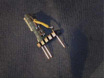

Here is the external watch-crystal oscillator I am using:
It is built on strip board (3 holes per pad) for plugging into my breadboard. The circuit is here: https://microchip.wikidot.com/8bit:t1secosc
Frequency was a little high with 8.2 pF load capacitors, so I increased them to 10.4 pF each. With my scope and counter (Racal-Dana #1992), the frequency is now about right. When I use it to clock TMR1 and capture known frequencies, namely 60 Hz and 1 kHz, the 2 or 3 significant figure results are right on, but the crystal is supposedly accurate to 20 ppm or so.
If you put any load on the crystal, such as with the scope, you change its frequency. Is there an accepted and relatively easy way to determine its frequency more precisely in the MCU circuit?

If this were an oscillator built in hardware separate from an MCU, I would measure the frequency at the output of a buffer stage which isolates the "load" from the crystal circuit.
However in this case you probably do not have access to such a point.
If frequency measurement and accuracy are important to you, consider building a separate buffer stage, a single CMOS inverter would be a good start, or maybe a simple source follower using a simple JFET.

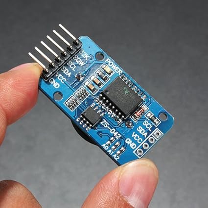

BTW: I use the DS3231 RTC, it is VERY accurate
That is an interesting chip and as your say, quite inexpensive. Probably worth getting a couple just to have around.
John
Yep, really too much, so I got an additional $0.10 discount each and bought three.

I would listen to Harmonics of the oscillator (or the cpu) on my general-coverage short-wave receiver between about 100kHz and 1Mhz. Then I would use my RF signal generator to zero-beat the harmonic. The generator can be connected to my freq counter, so I can measure the harmonic frequency to about 1 part to 10exp-9...
This way, the extra capacitive loading of the oscillator due to the measurement hardware is about 0.00001pF:D

For a modern clock that operates on batteries, a real time clock (RTC) chip is the only way to go unless you want to sync to the atomic clock signals available these days. That requires a receiver of some type. You might still want the RTC chip too though.

I can not see how a single, solitary stand alone crystal can perform as well as a dynamically temperature compensated crystal circuit, which is how the good RTC clock chips are made. Also, i would question what load capacitors to use and what type of capacitors would be used. They also have to be temperature stable. But even with the right caps, i cant not see it performing as well as the well engineered RTC clock chips. The idea of the crystal oven had to come from some problem that came up :)

I think you're over-imagining what the cheap RTC clock modules are :D
Assuming they do use special capacitors, then using the same capacitors on a PIC would give a similar result - the RTC's are just a chip with an external crystal and capacitor, just like TMR1 on a PIC.
Why do you imagine they are 'well engineered', and what do you mean by that?.
