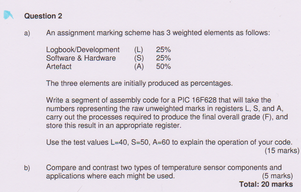

Hi.
There is a question which comes up in the mock exam which involves doing maths. Attached is the exact question. From what I understand, doing any kind of addition, division etc on a PIC in assembly is extremely difficult, this is some example code ive found:
Does this question really have to be this difficult, or is there any easier way of doing it?
- James

This particular problem is quite straight forward : As (L) and (S) are 25% this a simple divide by 4 or (shift right 2), and (A) is 50) or divide by 2 (shift right 1). To do it properly you need two routines Multiply and divide.You must remember that with fixed point arithmetic you need to take care of the decimal place.
Just use the two routines needed by Peter Hemsley.
Cheers Ian
Thank you for the reply. So I understand this correctly, to divide a number by two, you shift the binary once to the right, so 0100 would become 0010. To divide by four it would be 0001.
If we had the following:
Logbook (L) = 25%
Software (S) = 25%
Arteface (A) = 50%
The test scores were:
L = 40
S = 50
A = 60
Then in binary we would have:
L = 0010 1000
S = 0011 0010
A = 0011 1100
In order to get the right percentages:
L = 0000 1010 (moved twice to the right)
S = 0000 1100 (moved twice to the right)
A = 0001 1110 (moved once to the right)
Then we need to add them up and divide by the number of entries, in this case, 3. Is this all right up to this point?
James
Yes! but if you look at S then you will notice that 50 * 25% = 12.5, but as this is integer math you have lost the 0.5, so your end calculation will be wrong. In this case you are going to need Multiplication!!
Look at it this way 50 * 25 = 12500 or (for precision ) 12.500, No division needed. You really need to know how precise they need the results.
Cheers Ian

To prevent loss of accuracy do multiplication first.
Answer = (L+S+(A*2))/4
So, shift A left once, add L and S then shift it right twice.
Unfortunately this requires a two byte location for the answer so a compromise might be,
Answer = (L/2+S/2+A)/2
In the example
Answer = (40/2+50/2+60)/2 = 52.5 rounded = 52%
in code,
	bcf	STATUS,C	;clear Carry
	rrf	L,W		;get L/2
	movwf	Temp		;save it
	bcf	STATUS,C
	rrf	S,W		;get S/2
	addwf	Temp,W		;add L/2
	addwf	A,W		;Add A
	movwf	Temp		;save it
	bcf	STATUS,C
	rrf	Temp,W		;divide by 2
;answer in W
But, don't be tempted to use this code as your answer. It's far too efficient to have been done by someone at your level and your lecturer just won't believe you. He will probably ask so many questions until he knows it's not you code.:D
Good one Pommie! The only thing here is, If the tutor changes any percentages, the logic understanding all this... will be out the window.
Cheers Ian
I assume (hope) the percentages were chosen specifically with shifting in mind.
I appreciate the help more than you can imagine, I was really having a hard time getting my head around this.
From the last three years, all percentages have been either 50%'s or 25%'s so I believe bit shifting is the required solution.
Ill work to understand this and be able to apply it to new exam questions.

For the sake of keeping it simple, rather than efficient, I have modified the code:
For the most simple maths, it would be something like this:
(L/4)+(S/4)+(S/2) = Total
I believe I do not need to worry about the remainders. I have tried to write my own code based on the information provided.
// Divide L by 4
bcf STATUS,C
rrf L,W
movwf TempL2
rrf TempL2,W
movwf TempL4
// Divide S by 4
bcf STATUS,C
rrf S,W
movwf TempS2
rrf TempS2,W
movwf TempS4
//Divide A by 2
bcf STATUS,C
rrf A,W
movwf TempA2
// Add A/2 to L/4 then add total to S/4
addwf TempL4,W
addwf TempS4,W
I know not an ideal solution, but would it give me the answer I need?

Can I get any feedback on the code I wrote?
Your code should work fine. The method of pushing variables and functions onto a stack is how some systems function but it is not suitable for a pic microcontroller.

An alternative solution would be to do this;
L = (L+2) / 4
S = (S+2) / 4
A = (A+1) / 2
answer = (L+S+A)
This has the advantage of only requiring 3 byte sized variables and can never overflow any var.
