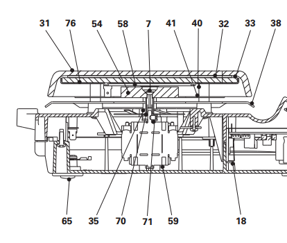

That won't work for what I have in mind because that can't be arranged in a circle. The magnet for the stirrer needs to be accessible inside it.

Not sure why the heater needs to be in a circle. Just use a flat plate heater, like from a toaster, under an aluminum or ceramic plate, electrically isolate where needed, and stir through it from below. Here is a typical design:
