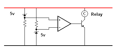

So i was going to use a voltage cuttoff like this to power a relay
how ever i was not thrilled about the current draw across the relay, so i found that you could use a IRF4905 to make a solid state high side switch no draw :).... so i drew this up
**broken link removed**TV

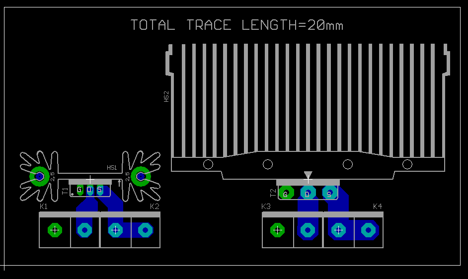

now i was drawing up my board so i could etch it and it hit me, can the PCB handle the draw im putting through it? the mosfet is rated to 5-10A (total as drawn 10-20A). the battery is 2.3A @ 12V(i know its over rated its an idea right now) now if i were to apply that load to it would the etched board take it with out acting like a fuse and burning up?
Use 2 ounce copper helps. Also you can remove the solder mask over the high current traces, then add a heavy layer of solder on the traces.

Hi browningbuck,
keeping the copper traces to the best achievable length reduces the trace resistance to a great deal. Of course it's impossible to route a trace of 1/5" thickness to the pad of a TO220 package, which requires reducing the trace width around the component pin.
Here are some numbers based on 1 oz copper weight, ambient temperature 30deg/C, total trace length 40mm (1.57") and 50A current flow (resistance values rounded to the nearest tenth):
trace width 5.08mm (0.2"), R=4.2mΩ, voltage drop=213.6mV, see remark*)
trace width 7.5mm (0.295"), R=2.8mΩ, voltage drop=144.7mV
trace width 10mm (0.394"), R=2.1mΩ, voltage drop 108.5mV
If those values seem too high you might either use PCB-material with 2 oz copper weight or a double sided 1 oz board.
The example shows 3.81 mm trace width for the TO220 package and 5.08mm for the TOP3 package.
Maximum total trace length is 20mm (10mm for a single trace)
* Remark: Although the value seems to be low the power dissipated in the trace is 10.68W.

Do we know what the load current will be? Somebody mentioned 50A, but I didn't think it was the OP.
no i dont know it for sure yet, so i was going to just assume full draw from the battery. they are A123 batteries in series creating ~13V

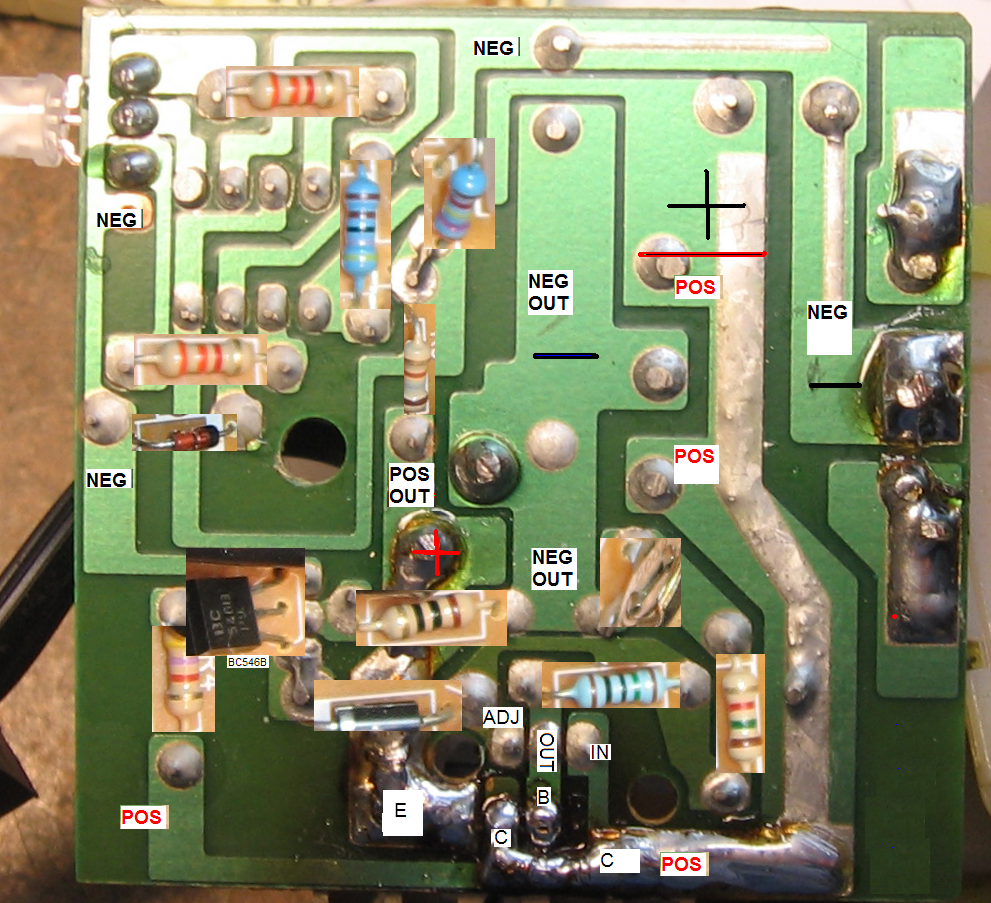

Here's a photo of where the copper traces have been built up with solder, I've used it several time and I fixed one PCB by building it up and bridging where the trace had blown out the surrounding copper on a current handling relay. Soldering down a small gauge wire to the trace increases the current carrying capabilities as well.

Thanks kinarfi, but i think that i will be using a mix between Shortbus's mosfet (if i can find the pchannel) with boncuk's copper trace...i need to now look into upsizing my resistors, and look up the spec on the V18ZA1 varistors i think i remember them being 100A.

What is that you are doing, if I understand correctly, you have a battery and want to monitor the voltage and drop it out if the voltage gets to low. Is that correct? and are you using a second voltage source for the monitor? If so, I may have some recommendations.
Kinarfi
yeah thats the idea,the battery is in a system that uses a stator(second source) to recharge the battery.
Edit: What do you have ????
Years ago, I had to monitor a battery for starting an emergency generator and send a signal back to head quarters via modicon or modicom, a closed set of contacts, and this is how I did it using the power of the battery being monitored to operate the monitor, the battery was on a charger, so the small draw was of no effect. I also used the same set up to monitor the voltage of a UPS system that had 120 volts of battery power, had to dissipate some heat on that one.
This is set to drop out / send a signal at 10 volts.
