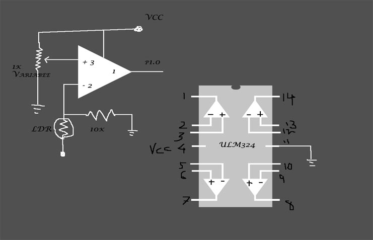

I am trying to make a line follower on a rectangular grid arrangement ..
I want to use a 89s52 to drive two motors and detect the lines using LDRs.I wanted to know how many maximum sensors can I use in the process ? I am a newbie to this so I assumed that I would use a clocked intrval for executing a 90 degree turn , but then what if the battery voltage decreases ? Can anyone suggest a better method ... expecting a reply.. and maybe someone can help teach me how to connect the sensors as well ..I have a circuit that uses a lm324 IC to compare the resitances and produces a outut signal.. but i am unsure as to howto connect it to the 89s52 ..plz help..

you can attache many many sensor to a 89s52.. more than what you will ever need.
i can't tell you if you can directly connect the ouptut of the op-amp sensors as i don't know how the opamps are configured..(a skematic would help)
i don't think the clocked interval would be a good idea.... allways rely on on sensors to tell you your exact position.. never rely on assumptions..

attached is the sensor ckt that i had found .. but i am unable to determine where to connect the o/p pins..
the 89s52 panel is the same as on the atmel site ..

you have to connect Vcc to 5V. then all you have to do is to directly connect the output of opamp to a pin of the microcontroller - as simply as it sounds - !
then in the programming part, for the pins attached to the sensor to act as input pins with which you can read the sensor, you have to initialise them as "1"
i'll write a litle C code to show you (this is not tested, there may be some syntax mistakes..)
void main(void){
P1_0 = 1 // set pin number 0 of port 1 to logic level "1"
