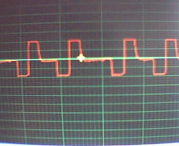

The ignition pulses (173517.jpg ) are displayed on a downloaded "sound card oscilloscope" and are from 16 to 18 Mseconds in time, they are step shaped. I don't know what the volts are; sound card scope can't show that. I believe the pulses are all above ground; sound card won't show that either. Pulses were "captured" with Radio Shack sound recorder then transferred to sound card scope on my PC.

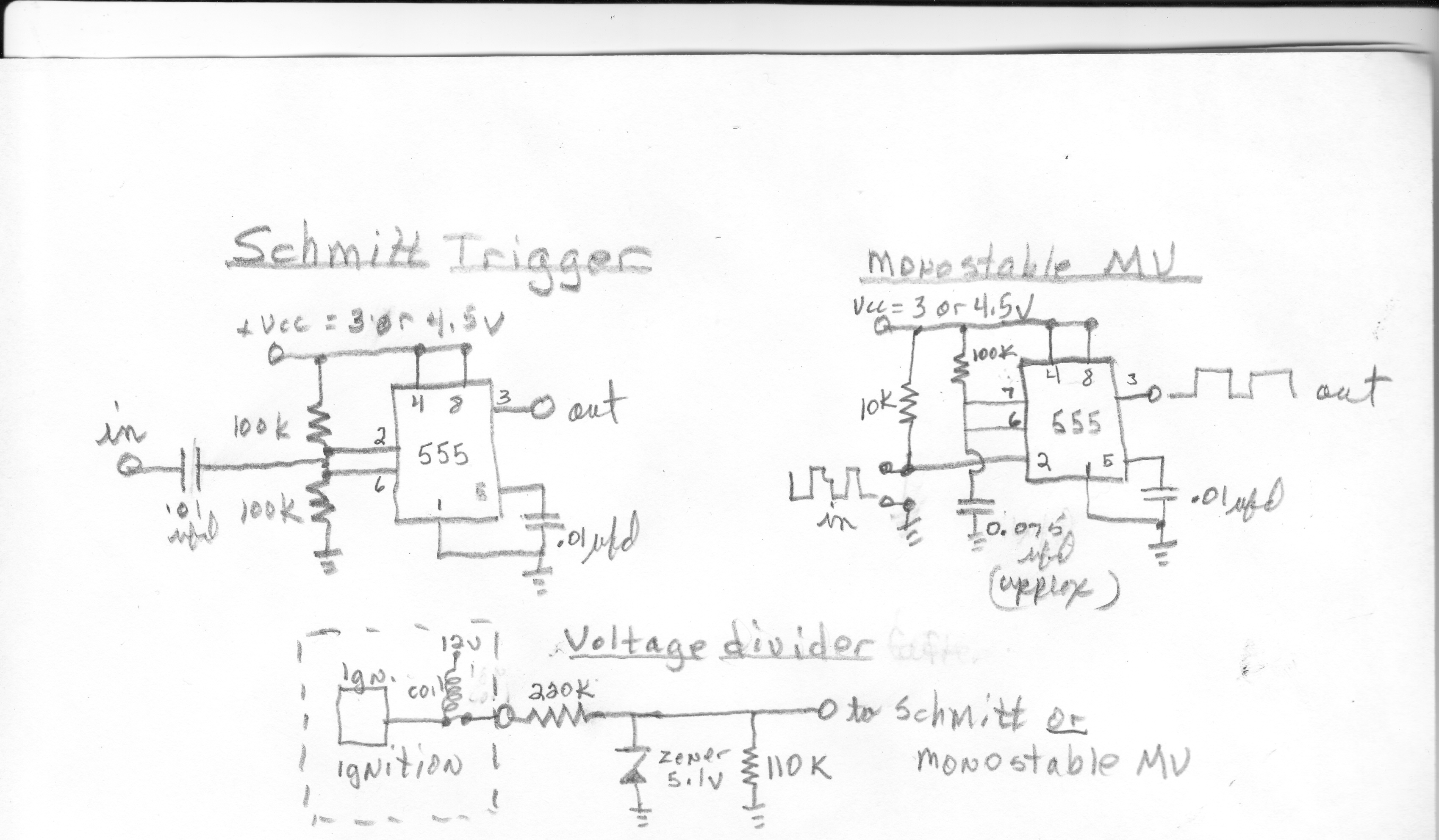

IMG.jpg shows circuitry.

I want to apply these ignition pulses to my Parallax Basic Stamp (BS2), and use the COUNT command to count the pulses per second. I've been partially successful at this, but pulses are not counted accurately (nor with consistancy) going directly from ignition to BS2. I used a Schmitt trigger between ignition and BS2, but the count was very innaccurate.

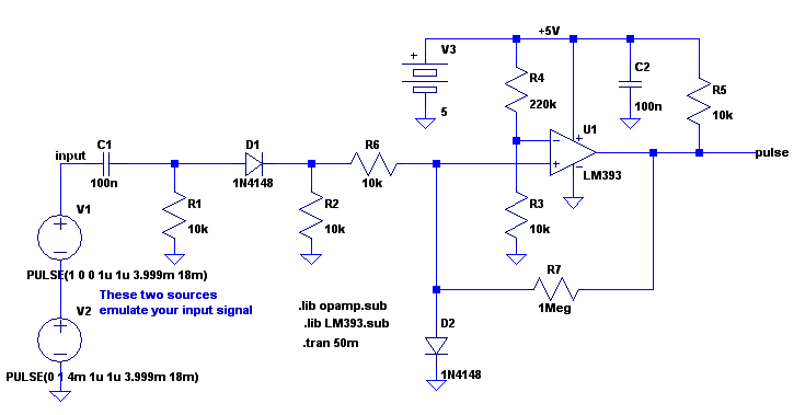

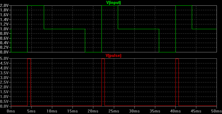

If the basic Stamp has a comparator or A/D input, you can probably apply the signal directly to one of those inputs to trigger your counter, if you know the input signal's amplitude. Otherwise, you should be able to use the circuit below. The circuit is a differentiator, followed by a clipper, then by a comparator which has a little hysteresis to ensure clean switching.
Be sure to ground one of the inputs of the unused comparator in the LM393 package.
minimum 10 kV, probably
The spark plug center electrode goes negative; it's hotter than the shell so the electron flow is better this way, just like a vacuum tube with cathode being negative.

I'm taking the pulses from the low side of the coil, which is in the twelve volt range.
I have several transistors, old and new, that I can try out. Any idea what type I should start out with?

You should probably first try MrAl's circuit, which is much simpler. My circuit was designed when I had no idea what your DC level or p-p amplitude was. I doubt that the pulses are all above ground, as you originally suggested. If they were, MrAl's circuit would need AC coupling on the input.

In the circuit that you suggested, what is the purpose of the second diode that is connected from the comparator's '+' input to ground, with the diode's anode connected to the '+' input ? [/FONT]
I was able to use the resultant positive pulses from the differenting ckt, right from the 'top' of R2, apply them directly to my BS2 and derive an appropriate pulse count. Since I'm applying the ignition pulses to a 3:1 voltage divider, the ignition pulses are dropped down to less than 4 volts. Then they are applied to the differntiator/clipper ckt with the resultant positve pulses applied to the BS2. For some reason the diffed. pulses were greatly attenuated at the input to the comparator, and were apparently too small for the comparator to sense. I'm wondering if the second diode has something to do with the sharp attenuation of those pulses. If the diffed. pulses continue to work ok, that might be all I need to use.
The original ignition pulses are 'negative' pulses that drop from the MC's 12v to ground for a few milliseconds then back to 12v, with an approximate frequency range of 17 to 75 pps

The diode in question was put there because, when I designed the circuit, you didn't know the amplitude of the input signal. The diode limits the amplitude of the pulse at the '+' input to about 0.7V, to protect the comparator from possible overvoltage. If you know that the signal at R2 is adequate to trigger your comparator, and won't subject it to overvoltage, then use that point.
