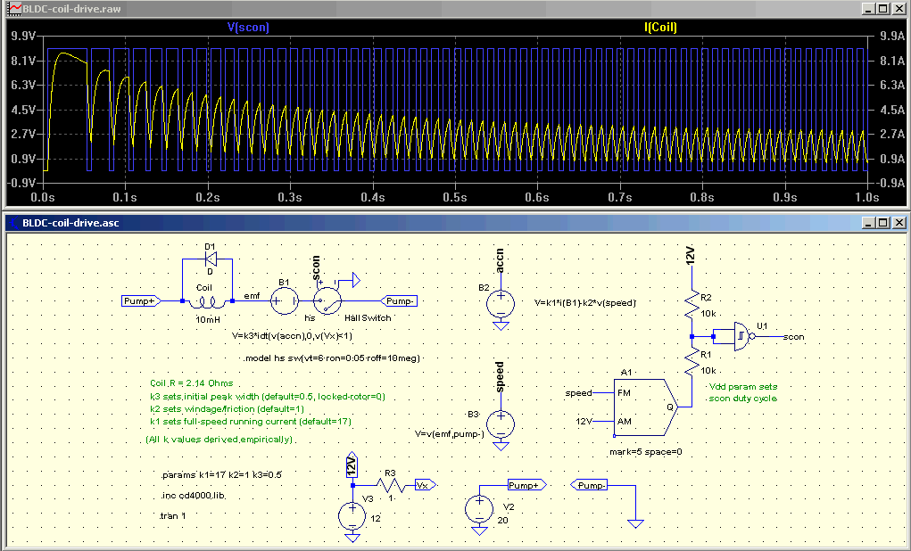

This BLDC coil drive sim (extracted from a sim for a different thread) may help to explain it :
  • BLDC-coil-drive.asc
thanks, though I must say that that sim contains some symbols etc not in LTspice library and it wont run,
Which symbols? The only non-LTS one is a CD4093 Schmitt gate (used to square-up the scon signal and allow adjustment of the mark/space ratio by editing its Vdd value). The Modulate device is in the 'Special Products' folder.
