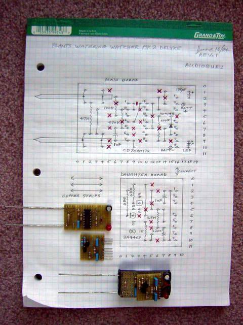

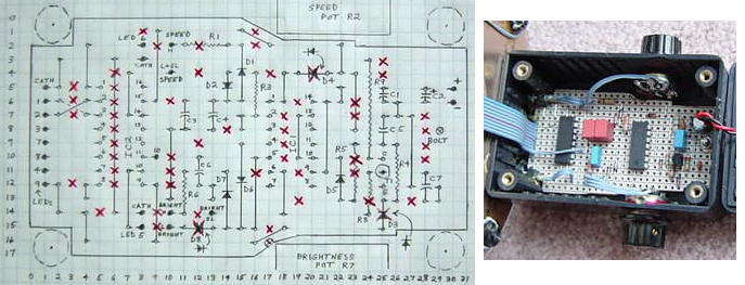

I have mounted ICs on Veroboard (stripboard) for more than 30 years.
I just cut the tracks between IC pin rows (I plan the wiring to avoid some cuts) with a track-cutter tool or drill-bit. Other tracks need to be cut anyway.
You can plan the strips of copper so that half the printed wiring of a pcb is done by the strips. The remaining wiring is done by lying-down resistors, capacitors or a few jumper wires.

I like to exercise my brain with the puzzle of planning Veroboard layouts. I have software but prefer to take my graph paper where ever I go.
With plain perf board and many wires, it is difficult to change a part. With my Veroboard (stripboard), each wire has its own hole so changing parts is simple.
Laying out a circuit is especially challenging when it must fit into a certain confined space, like the one I showed and like my Plants Watering Watcher-2 project that is the same size as the holder for 2 AAA cells, using a daughter board. It was tricky to get the pins on the daughter board to line-up with the signals on the mother board.

I used to design my strip board on component side like yours and almost everybody else but then I switched over to design at the copper side. I find it much easier that way. I guess that would be different with different people.
Then you must be left-handed. :lol:
I have had more than one times cut the strip board at locations according to my paper design(which I forgot to flip over), and realised the fact when I have nearly finished cutting them. :twisted:
