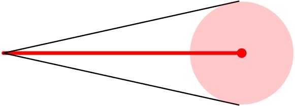

Keep in mind when using an IR thermometer:
The IR sensor's field of vision is cone shaped — the angle varies depending on the unit, but it's relatively wide. The temperature measured is not the temperature at the laser spot. It's the average over the field of view of the sensor. A relatively large circle around the laser dot.

when measuring mosfet do you measure on plastic body? And what emisivity should be set for plastic package? I used to measure heatsink becouse reading on mosfet package is way lower.
The specs for the Uni-T UT-302C say the Optical Resolution (D:S – Distance:spot) is 20:1. This is quite good, meaning if you're measuring from a distance of 20cm, the spot size (measurement circle) is 1cm. If you measure from 10cm, the spot size would be 5mm.

I would take the highest reading you can find. You can be certain the temperature of the package is greater than the temperature of the heatsink.
