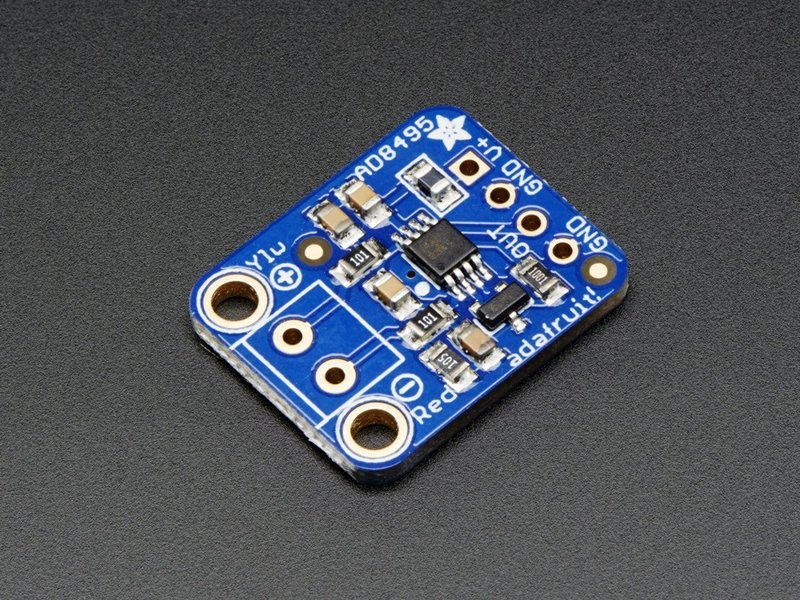

You need to use a conditioning amplifier, and ideally a dedicated device made for K type interfacing, that has the cold junction compensation built in.
Something like this, that has compensation and linearization built in:

The module in the first link has its output levels printed on the back; 1.25V offset at 0'C [LO] and 5mV per 'C scaling, making 500mV over 100'C, 1.75V out at 100'C [HI]
Convert those to the ADC count at whatever ADC ref voltage is in use, and plug them in the calculation I gave before.
eg. With 2.5V ref, 1.25 / (2.5 / 1023) for LO and 1.75 / (2.5 / 1023) for HI; 512 and 716
