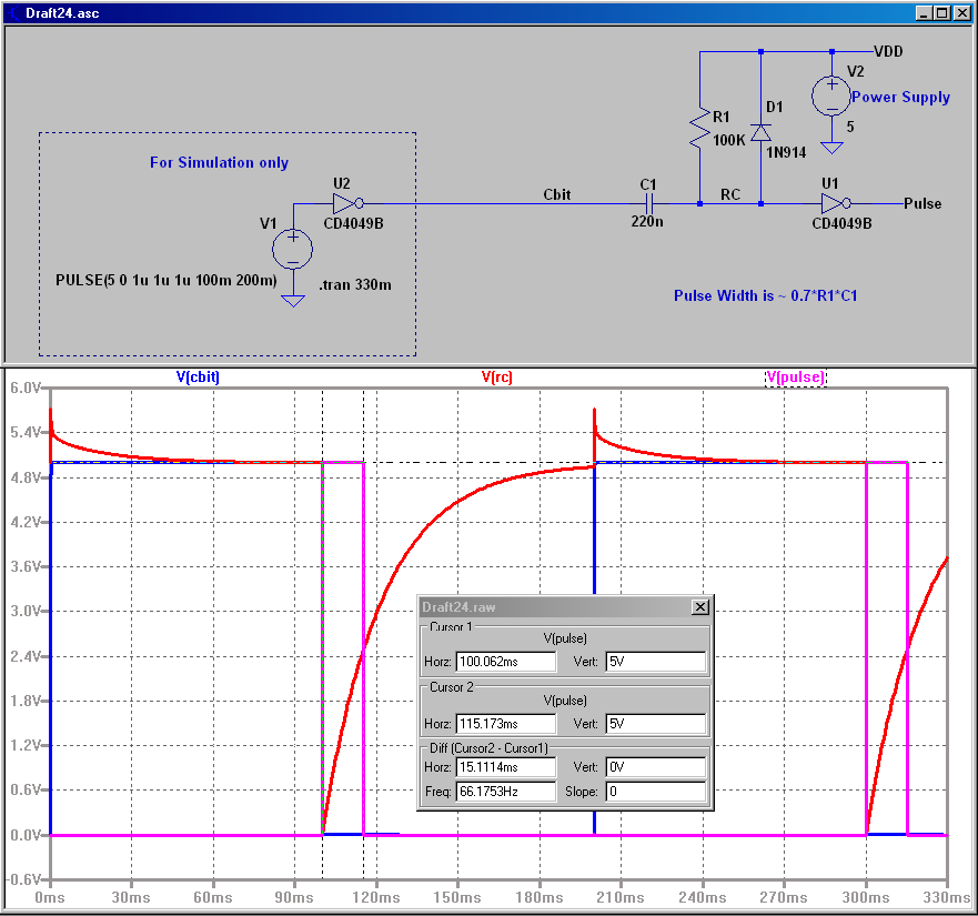

Cbit is your counter output bit. The network consisting of R1 C1 and D1 applied to the input of a hex inverter will create a pulse that you can set the width of.

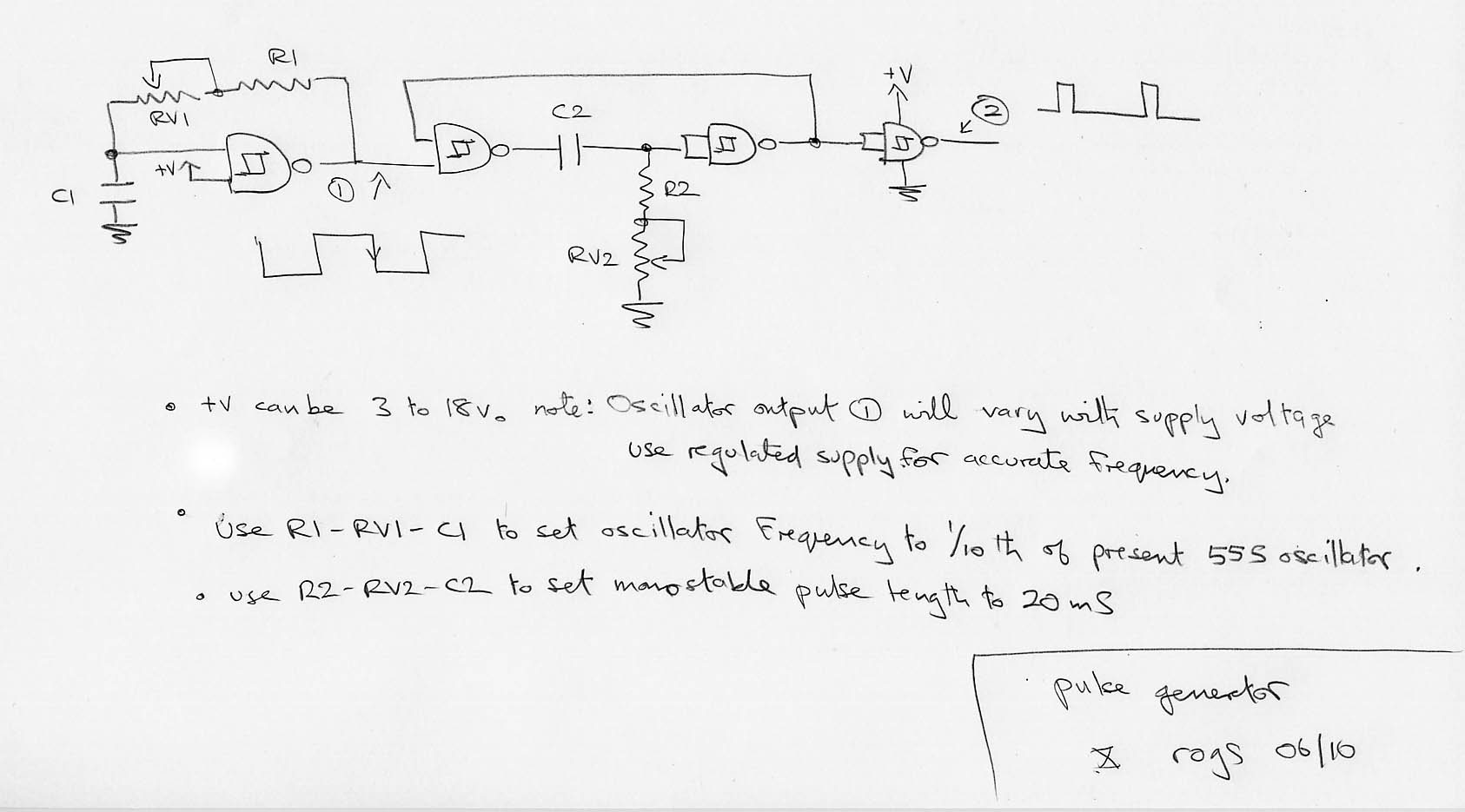

Do away with the 555, and the 4017, and just do the whole thing with a single 4093! (See sketch)

MikeMI, you are way above me. It looks interesting, can you explain more?
Think of the stuff in the dashed box in the simulation as your GPS disiplined counter...
It has a fixed period (derived off the GPS). You want to extract either the positive or negative going edge from some counter bit V(Cbit) and use it to create a fixed, but relatively narrow pulse width. I show how to select the falling edge to create a fixed width pulse V(Pulse). Look at the traces in the simulation. Note how the width of V(Pulse) is determined by R1 and C1. Vdd can be anything appropriate for the 4017 and 4049 CMOS logic.
