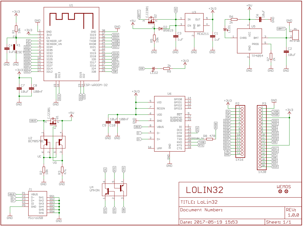

Hello everyone, I am trying to make my own custom board for which I am thinking of programming the ESP 32 microcontroller via USB. I have seen the PICO D4 Development kit which uses a CP2102N but not sure how to use it. I am trying to keep my PCB as small as possible so I am thinking of using the QFN-20 package. Would like to know how to connect it to my MCU.

Here's a good start from the EEVBlog forum. This gets you the USB side (data and power).
On the microcontroller side, remember RX-->TX and TX-->RX (i.e., they are swapped.).

That appears to not use Vusb but a separate 5V supply. Actually, two - 5V and Vdd - how strange.
To the OP, the schematic for the Wemos Lolin ESP32 board is freely available.

Thanks, I am thinking of using the 20 pin QFN package but DTR is missing would that be a problem?

I think DTR is used to reset the processor when the software needs to talk to it. The QFN24 has DTR and is only 4x4mm.

right, but the 3x3mm qfn 20 doesn't have DTR, I sometimes use an FTDI board without DTR, would that be ok for me? Is DTR necessary when dealing with UART?
The circuit above is designed to run off a single Lipo battery and charge it when the USB cable is plugged in. Will this do what you want?

I see there is a DTR pin that is not used and is NC. Is that ok? So now If I follow this circuit (even with the QFN 20 package) then would it be fine?
If you look at both the schematic I posted and the one you did, they both use DTR along with RTS to toggle the EN line on the processor. So, I think you need the DTR line. Which battery charging IC do you have?
