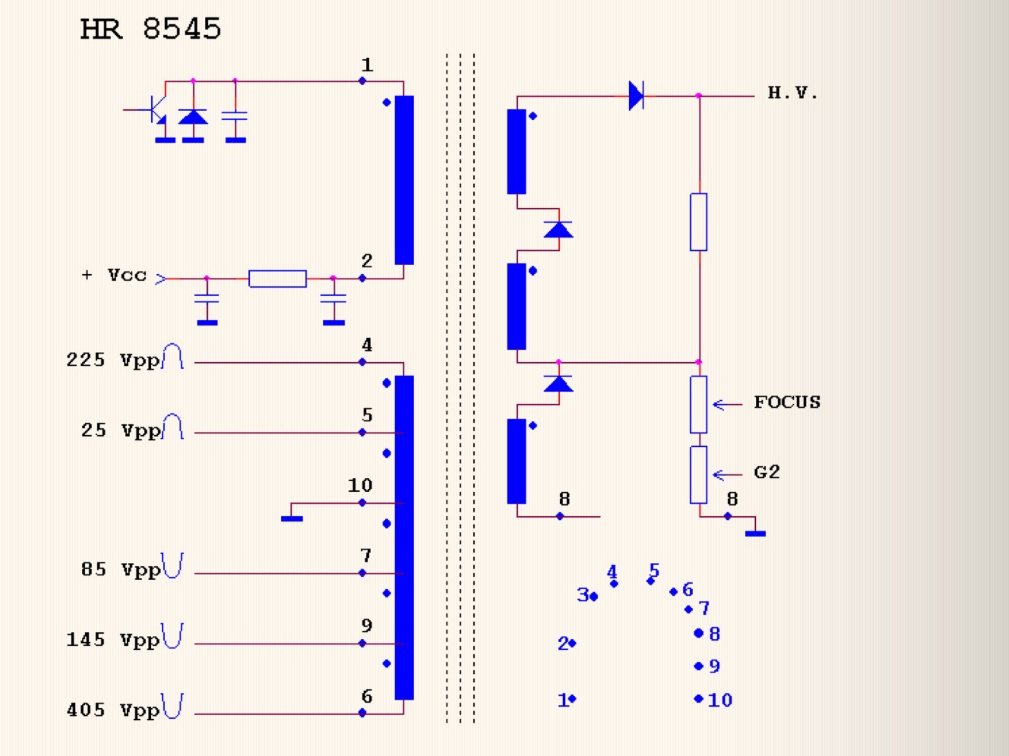

Hi I recently acquired a flyback transformer for the purpose of creating a high voltage power supply but due to my ineptness I was unable to determine which pins were the ones I needed. I do believe I have the basic schematic of the flyback transformer, any assistance is greatly appreciated.

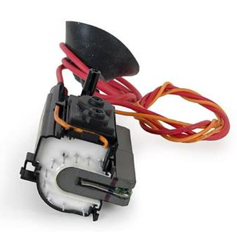

The main high voltage output is normally a wire with thick insulation on it. It will probably have a high voltage diode in it between the transformer and the CRT final anode connector.
I have not seen one with the three secondary windings in series (With the two extra diodes.) All the components shown on the right hand side of your schematic may be encapsulated in a moulding on the transformer and the focus and G2 connections will probably be on this moulding.
Les.
Red wire is HV
The orange is for the Focus and G2.
The other pins are probably not like your drawing. (could be)

When using the FB transformer you really need to get pin 8 connected to ground.
Hopefully you have a meter. Check the resistance from G2 to pin8 while you turn the pot. Probably the resistance will be in the 2 to 5 mega ohm range.
There should be resistance from pins 1-2 but that pair should not have resistance to any other pin.
Pins 4,5,6,7,9,10 should meter out fine and have no connection to any other pin.

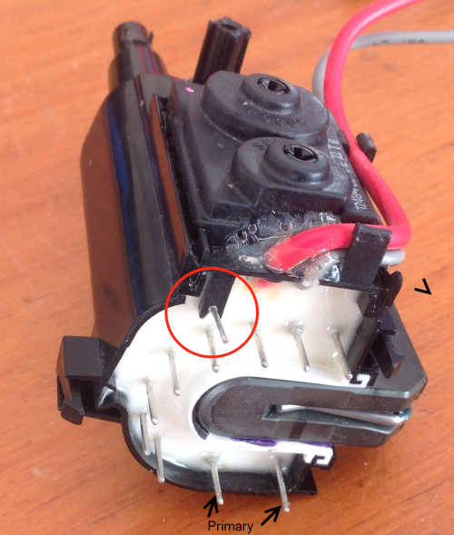

This is the flyback transformer, it did not come with a high voltage output wire but I have other wires I could use.
The high voltage output wire has been cut off. You will not be able to access the high voltage (40kV) easily.
Your primary is usually the two widely-spaced pins all the way at one end of the horseshoe. The two at the bottom in your picture are likely what you're looking for. The other pins are different secondaries, and the only way to really check them is to measure them with a DMM able to withstand the voltage.

I marked the primary.
I put a red circle around a pin that is not in your schematic. It probably has something to do with the HV section/ bleeder/focus pot area.

That pin I circled in red is likely the ground end of the high voltage capacitor on the HV output.
Some times this pin is connected to ground. I connected it to a capacitor/resistor to ground. It is used to filter the HV and to give ripple information back to the HV regulator.
If I had it I would apply 30 volts 32khz across the primary and see what the other leads are doing. That way I would know phase and turn ratio. At 30V not 850V the HV would be low enough that a meter can read.
Could the EHT wire have been cut off or could there be a plug and socket connection on the cylindrical part of the moulding at the top left of your picture. Compare it with the point where the wire comes out of the transformer in the picture that ronsimpson posted. (Post #3) Also what is on the end of the red wire ? If it has the type of connector that connects to the CRTs final anode then it is the high voltage output.
Les.
ONE. We don't know where the transformer was used. If it was for a Sony CRT then the "red wire" is at 20 to 30% of the HV. (real hot)
This type of transformer must have the HV out the top. I know this style. It is layer wound, sager tuned, there are many diodes inside, one/layer.
