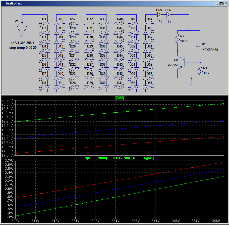

Been having a play with it in LTSpice. Found it to be quite sensitive to the values of resistors in the pd. R2 at 560k and R1 at 10k with a 3v3 zener gives me 240vdc. Can't seem to get a voltage between 220 and 240v

  • Draft5.asc

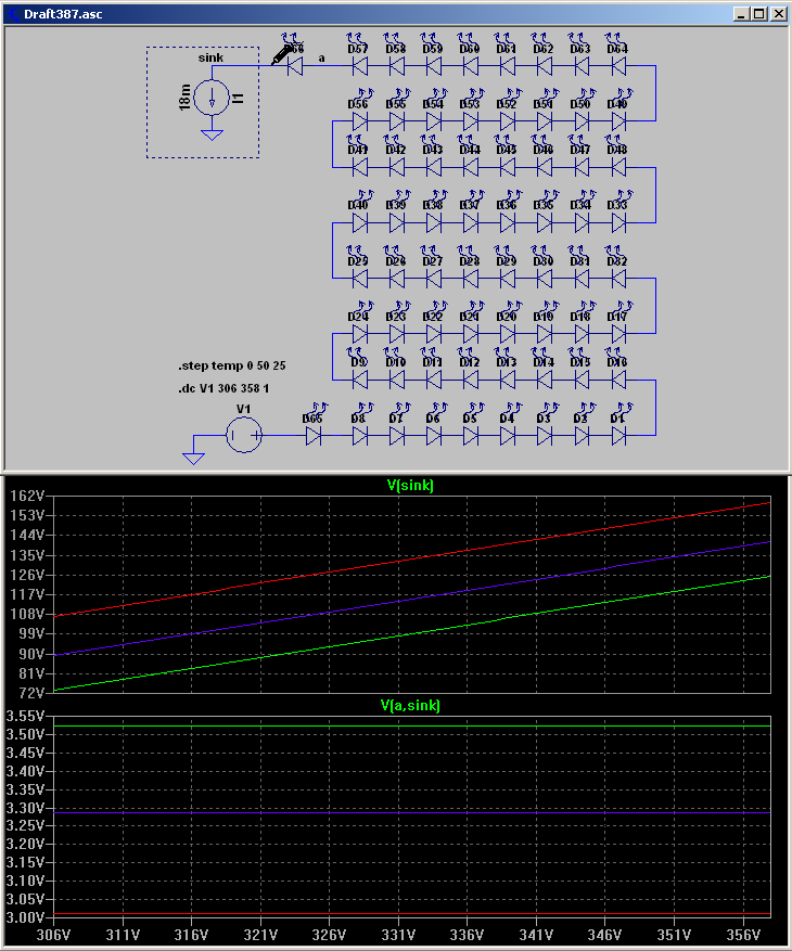

Back to what you posted as requirements in post #1: The voltage standoff requirements for the current sink are more demanding than you thought. Here are 66 Leds with a nominal Vf=3.3V@18mA. I vary both the temperature (TEMP) and the source voltage 306V<V1<358V.
The upper plot pane shows the voltage drop across the current sink V(sink) at three different temperatures Green=0 degC, Blue=25 degC, Red=50 degC as a function of V1.
The Lower plot pane shows the temperature variation in Vf of a single diode @18mA.

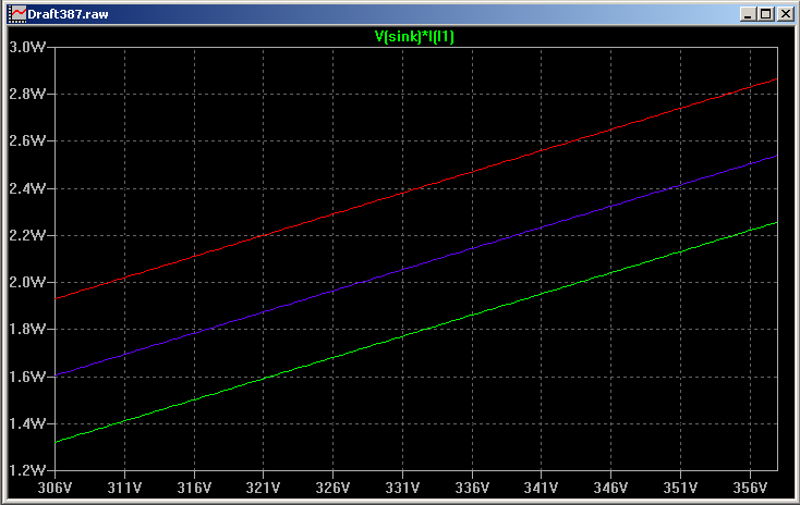

The power dissipation in the current sink is shown below, so it will have to be adequately heatsinked...

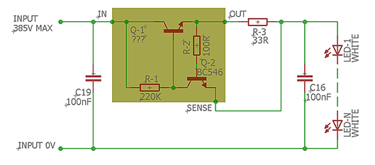

Tony this circuit has a number of problems.
(1) It is overly complicated: just one NMOSFET will do the job
(2) The constant current is ill defined: the gate threshold voltage of an IRF640 is 2 to 4V and that is ignoring temperature effects, so the constant current will have spread of 2:1
(3) R4 is incorrect: should be 170R. 180R is the closest standard resistor value. This is to give a constant current of 18mA with the average IFR gate threshold of 3V.
(4) That combination of PMOSFETs is certain to oscillate: there are no gate stoppers.
(5) The characteristics of the reservoir capacitor are not specified.
(6) There is no LF or HF decoupling
(7) The circuit is a safety hazard on a number of counts but at least it needs a mains fuse.
(8) The working voltage of R1 is not specified and will exceed the voltage rating of common resistors
That's quite an eye opener, Mike. Luckily I'll be using it round about room temperature and it won't have chance to get particularly hot. Looks like I really need that supply voltage limiter though...

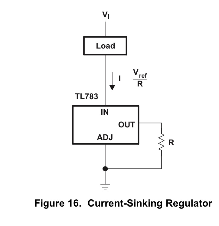

I agree the TL783 (125V) is the simplest solution, with suitable voltage drop R and ( don't forget 500V rating) from 352V bridge peak to cap. with suitable holding current for 10-20 ms.

While this is a good approach, even the TL783 will not do the job because it only has a maximum input output differential of 125V and around 162V or possibly more is required by the constant current generator.

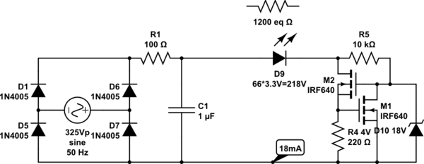

The only minimum solution I could come up with for a high-voltage constant-current generator is similar to Tony's post #4, except with a bipolar sense and pass transistors and a high side, rather than low side configuration as shown below.
In effect, you would be constructing your own LM317 as shown on the schematic so the home made LM317 could simply replace the LM317 in your original circuit. The current sense resistor is calculated by IK= 0.6V/R-3 and needs to be the value shown in the schematic for 18mA Ik.
spec
WARNING: THIS CIRCUIT HAS HIGH VOLTAGES AND SHOULD ONLY BE CONTEMPLATED BY THOSE EXPERIENCED IN HIGH VOLTAGE ELECTRONICS. ON NO ACCOUNT TOUCH ANY PART OF THE CIRCUIT WHILE THE CIRCUIT IS PLUGGED INTO THE MAINS SUPPLY
NOTES
(1) C1 and C2 are 400V minimum disk ceramic (not surface mount) capacitors X7R dialectic +-10% or better
(2) R-1 is 400V minimum voltage.
(3) The pass transistor Q-1 needs to have a VCEo of 400V ideally and be capable of dissipating 2.9W which, without a heatsink, implies a TO220 type. There are many transistors that would meet these requirements.
