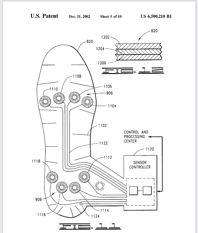

Hello everyone, I am trying to add force sensors to my shoes to see how much force I can apply with my feet. I am using a Microcontroller to measure it. But not very sure how to use a Force sensor. I am trying to use around 8 sensors around the feet to get even sensing of the force exerted to get an accurate reading. I have drawn a small diagram as to how I wish to place these sensors.

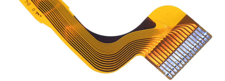

I dont know how to house these sensors. I can't use a flexible PCB, because it wont fit in. I am thinking of wiring it manually to solder points on the PCB. Is there any other way to connect these sensors in high mobility areas? Do let me know

Think about "flexable PCB".

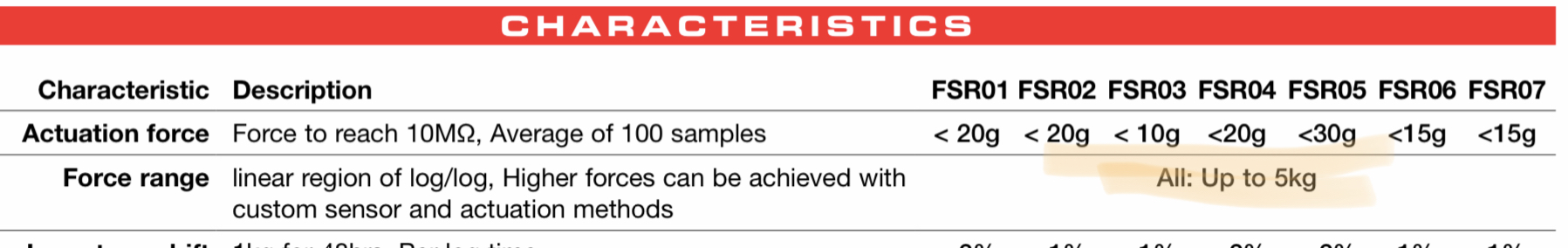

you can do through-hole components with polyimide flex PCB but, the sensor you suggested has max force of 5 kg-force.
Yes, but I am placing 8, maybe more to extend the range of the force applied. Are there any sensors that you know that can take higher force?
If you walk perfectly flat footed and distributes the weight of your step across all 8 evenly, then, yes, your 40kg body will be fine with 8 sensors when running. But, if you intend to sens various weight distributions across various pressure points on your foot, then you might run into some challenges with your plan.
Look up Force Sensor on Digikey.com or .mouser.com and you'll see the price jump significantly for higher force sensors.
But even if someone was not perfectly flat footed, which is going to be the case, then the force will be applied to one side of the sensor. So most of the weight/reading can be taken from there. Is my logic right?
Look at the design of your foot - or step in some water snd then on dry concrete and then decide how/where you will place 8-sensors that provide meaningful data yet do not see more than 5kg of force when the subject is doing normal activities. Then report back to let us know if you think a 5kg sensor is suitable.

Coil Placement: There were a total of 8 coils ... 4 on the front and 4 on the back. The values were treated deferentially to form two vectors (Front<-->Back) and (Left<-->Right)... i.e. for front ALL four coil values were added together and on the back ALL four coil values were added together and subtracted from the front accumulative value. Likewise for left and right.... the left two coil values on the front were added to the left two coil values on the bottom and subtracted from the sum of the right two front coils and the right two bottom coils. Then finally those two vectors were combined into ONE single vector by applying SINE and COSINE to determine the deg from 0 to 360. As a person applied their weight, they became a "human joystick" as to where they were moving their weight.

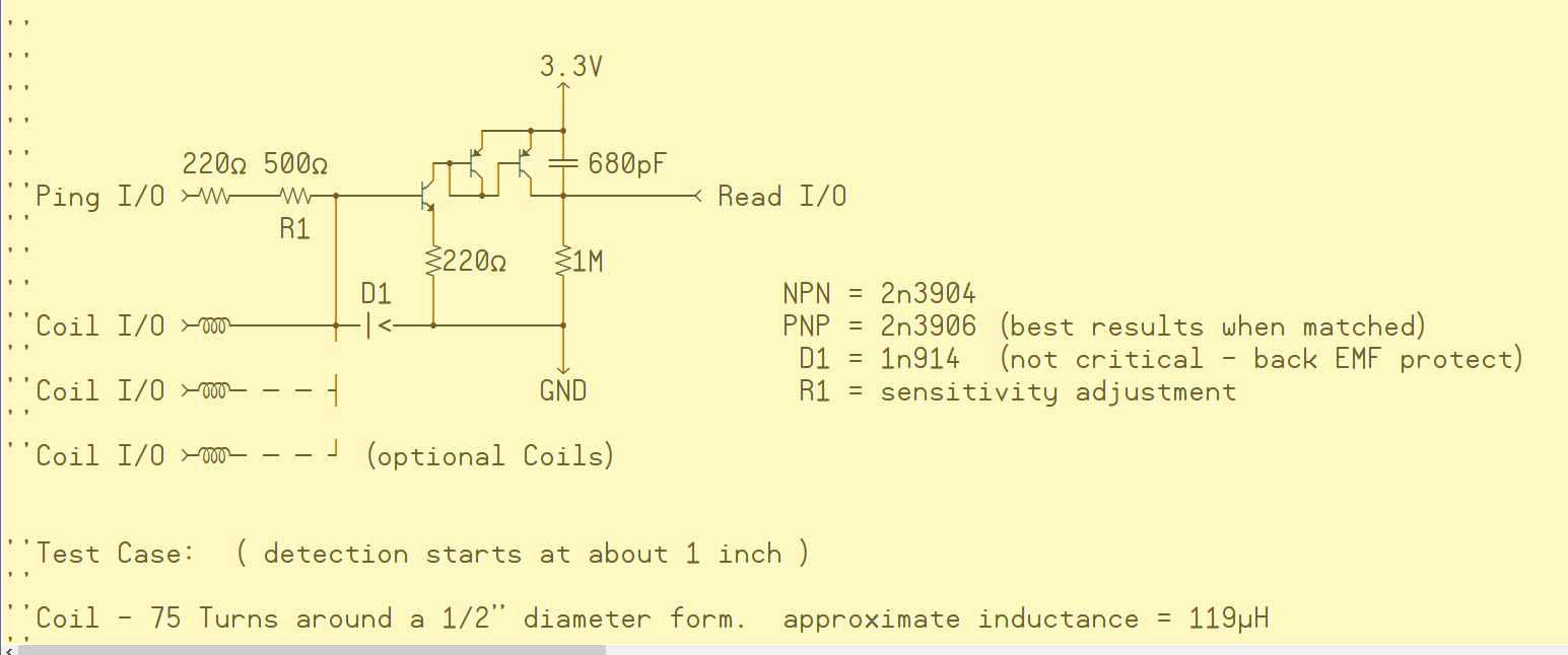

Here is a schematic of the coil read section ... The Ping is the 1us pulse from the micro. Each coil can be connected to an I/O on a micro for multiple coils, but ONLY ONE coil should be read at a time. When a coil is not activated the I/O is made into an input. When the coil is active the corresponding I/O is made an output and LOW. (Be sure to preset the output LOW before making it an output). The Read I/O is connected to an ADC.
It has been awhile since I designed and used this circuit but it does work quite well. The nominal coil is 100uH but is forgiving. I would build this circuit out first and just look at the Read I/O with a scope to gain an appreciation of what is going on. Set the ping to just send a steady stream of 1us pulses every 1/2 second or so with a single coil at first to get a feel for your voltage levels. Adjust R1 and play with the 680pF cap value. For 5V operation use a 330 Ohm resistor in place of the 220 Ohm.
Note: The original circuit had a 330pF cap where the 1M resistor currently is and the 680pF cap was not there. This had a sample-and-hold effect while the ADC had time to read the value (remember designed when processors were a bit slower). In this configuration the capacitor needed to be discharged before every read through software on the same Read pin. You may want to consider that configuration as well.
