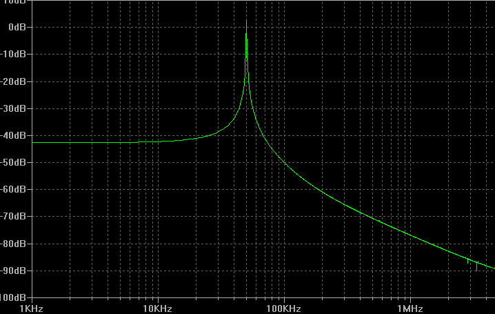

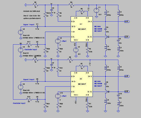

Hi Abdullah2121,
There's a easy way of doing this: You can mix both signals with
the same oscillator signal and pass them to equal low-pass filters.
If you use 1,65 or 1.75 MHz you'll end up with two 50 kHz signals
with the same phase difference. Do I need to say more ? ;)
on1aag.

Hi Abdullah2121,
Abdullah2121 said:
thanx guys for all these answers ... but all i
know that all chips like PLL or XOR gate or phase comparator or the
mixer deal only with the square waves not with the sine wave ... if not ,please give me the number of this chip , and i will be greatfull
for this ... and I'm sorry if I bother you ..
I think you should reconsider using the mixers to bring the frequency
of both signals down to manageable levels for the pic. I used 50 kHz
as an example but you could bring the frequency of the signals even
further down by selecting the frequency of the oscillator closer to
the frequency of the signals.
And the signals are all sinewaves. :eek:
on1aag.
