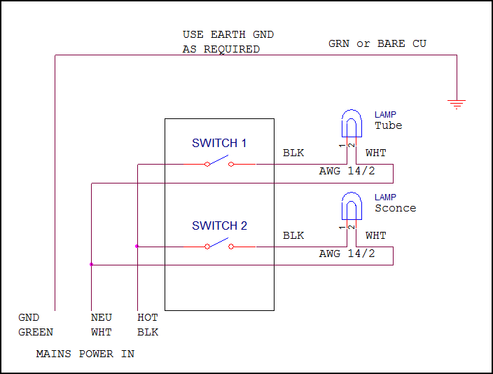

Yes, the switch you picked will work just fine as two switches in a single gang box. When you are done things should look like the attached drawing.
Run any grounds as required. Hopefully you can come off the switch box with two runs of Romex AWG 14/2 W/ GND. The drawing is just an example. Since you have this apart obviously you know to make sure the branch circuit is DeEnergized (Power Off) and to observe caution.

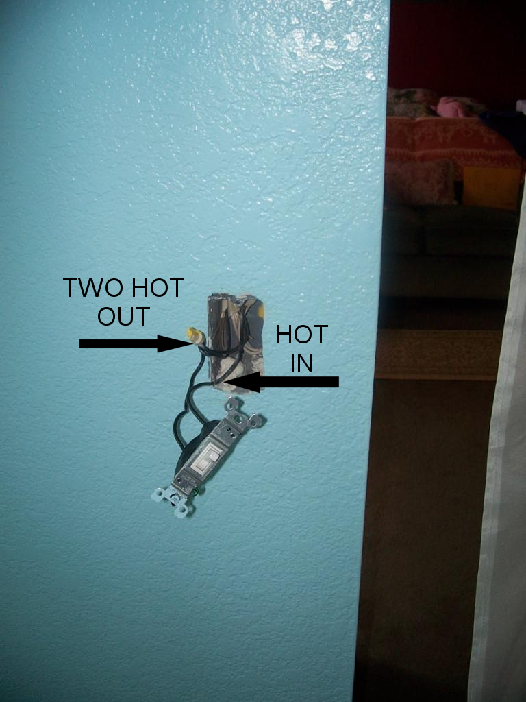

It looks like a hot single enters the switch and a hot exits and a wire nut sets up two switched hots exiting the wall switch box.

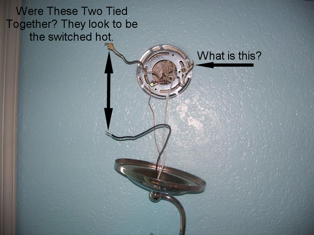

The Sconce looks to have a single hot coming in?

You are sure the switch has a single hot and that hot also runs out to a closet? With power off you can disconnect one of the two black wires in the wire nut. Isolate it and power up and see what does or does not work. I am just not seeing this as you are. My guess is the single wire to the switch is the hot in. Then off the switch they split the switched hot, one for the tube lamp and the other for the Sconce light. Granted that doesn't explain the closet light you mentioned.

I think you have it backwards.
That is One Hot into the switch, and One Hot feeding the closet switch.
There is One Hot out to the sconce.
Yeah...all 3 of those Hots are tied.
One comes from the switch.
One goes to the tube lights, and the third is part of the sconce fixture.
OK, then from the looks of things as you said the power for the tube light runs through the box for the Sconce lamp. If you can get lucky you can pull a short piece of 14/3 between the box with the switch and the sconce box. Go to the double switch and make it like I drew it. Another option would be to add another short length of AWG 12/2 between the switch and sconce box. Either way it ends up looking like the drawing I made. The now single hot peeled off from the closet line will go to one side of both of the new switches. One switch out to the sconce and the other to the tube lamp through the sconce box. It won't be easy threading a new line through the wall but I don't see an easy way around that.
