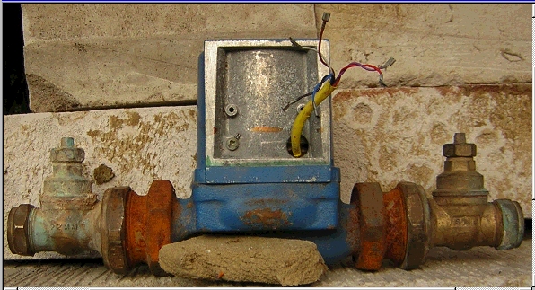

Heres a pic of the front of it, the motor part is about 90 mm dia,
the pump part is at the base and is about 95 mm square,
the flat part on the left is where the plastic box sits with the
capacitor and the 'head' control.
John :)

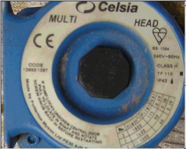

another pic
another pic

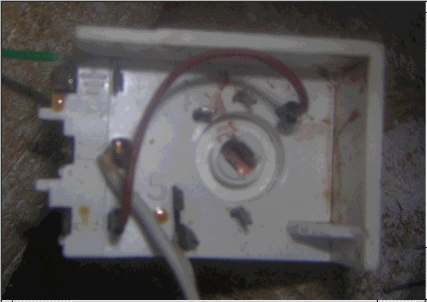

I have managed to get all the background in focus.
Pity about the white object.
However you can make out the baby spade terminals,
three across the top of the rotary switch,
the one on the right did not have a spade fitting on it,
it has a wire soldered on,
the other two had spade fittings on them, from the motor.
The one at middle bottom of the rotary switch
had a spade fitting on it, from the motor.
The six conections shown on the left are actually
three connections each with two connectors showing.
The bottom pair are both the live connection.
The middle pair are both the neutral connection.
The top pair are both the earth connection.
The middle double connector is the supply neutral and has a wire to the
capacitor, and a spade fitting on it, from the motor.
The bottom double connector is the supply live and has a wire to the
rotary switch, and a spade fitting on it, from the motor.
There are two white wires from the capacitor,
one goes to the middle pair of connections, neutral
the other goes to a connection marked '5' which is a
double connection with two spade fittings on it.
This connection marked '5' also had a motor wire fitting on it.
So from that i could draw up a 'sort-of' schematic,
but it would be pretty vague ....
John :)

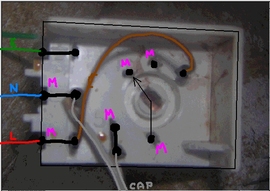

A 'sort-of' diagram.
I will have to look again at that rotary switch,
something doesn't look right there.
I may draw it out properly,
to see if i can figure how the motor is to be wired.
Ive put the motor wires as an 'M'
there are six of them.
Any help with this would be appreciated.
Regards, John :)
Checked out the switch.
That is how its laid out.
John :)
I hope i've traced this right.
but i dont see how to connect the motor.
Maybe someone else could see it ...
John :)
That looks about right but I can't help you connect the motor because I know as much as you.

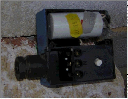

I have looked at my spare pump and taken some ohm readings which are tabulated below
I've used arbitrary numbers 1 to 8 on the connectors. The connection box is plugged to body of pump.
Readings were taken with a DMM set to 200 ohms range
Switch readings were taken at each of the 3 positions (I would take the ohms readings with salt)
readings were done in sequence: 1-2, 1-3, 1-4 etc, then 2-3, 2-4, 2-5; 3-4, 3-5 ... and so on to 6-7.
Make: GRUNDFOS
Type: UPS15-50x18
Model: C
No: U740
Motor Coil Resistances
---- 1 ------ 2 ------ 3 ------ 4 ------ 5 ------ ------ 7 ------ 8
.......1------------------- -165 ohms -------------------7
...................2 --- 135 ohms ---4
...............................3--- 132 ohms --5
Junction Box and Switch
Connections
---- 1 ------ 2 ------ 3 ------ 4 ------ 5 ------ ------ 7 ------ 8.
.......1 Neutral
.................. 2 Live
..............................3 -Link- 4
..... 1 --- 2.5 micro Farads 400Vac ----5
Switch Position
---- 1 ------ 2 ------ 3 ------ 4 ------ 5 ------- ------- 7 ------ 8.
one..................................................5 --- 55 ohms --- 7
two......................................4 ------ 65 ohms --------- 7
three.............2 ----------------- 30 ohms ---------------- 7
