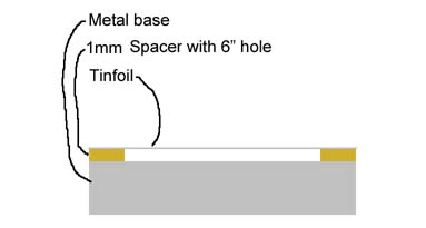

I thought that I could get some audio output from doing this: I cut a 6-inch hole in the back of a tablet (thin cardboard) and taped 7x7 pieces of tinfoil on each side so the 2 foils were maybe 1mm apart. Then I connected a 9V battery to the 2 sides through a 5Meg resistor. I connected my scope to the 2 foils and clapped my hands and expected some audio output, but couldn't observe any. Am I off base on this?
Don't the two plates of the capacitor move together? One would have to be stationary, while the other is attached to a diaphragm which moves with sound pressure...
A condenser mic has only a few microns of gap between the moving foil and the fixed perforated backplate. Then a voltage of 48V is applied through a very high value resistor. The output is extremely high impedance and is buffered by a Jfet or vacuum tube. A modern electret mic is the same but has the 48V permanently stored in the electret material and has a Jfet impedance converting buffer inside.

Surely, with bigger plates, a bigger gap is possible? Other thought is, rather than thin card, a piece of plastic film might be better, like the window off a cake carton or something. One plate could be stuck down to something to make it more rigid.
There are designs for FET scope probes out there - maybe one of these could be used to capture the signal. Otherwise the scope has a low impedance input compared to the "mic".

MikeML: Yes, I changed the setup so that the bottom is a plate, not tinfoil.
Prprog: Yes, it is totally like a capacitor. I thought it had to be kept charged with a "phantom" voltage supply.
Throbscottle: I've attached an image. A scope has a 1Meg impedence. I thought that was high.

A funny thing is that at one point I thought I saw just what I wanted -- a response to my clapping of hands. But now there is only the 60Hz AC noise.
The tinfoil is taped to be taut.
Now you are making a "condenser" microphone. It needs a 48V external power source which is called a "phantom" supply.
Since you have a "stiff" thick foil membrane (an electret mic has an extremely thin metal film deposited on a thin plastic membrane) and you have a huge 1mm space then its output level will be so low that it will probably not pickup very loud explosions.
I guess you did not look at Condenser Microphone in Google to see that the 48V is fed to the diaphragm through a resistor with a value of 100Mega-ohms to tens of Giga-ohms and the preamp needs an input resistance the same or higher.
All microphones feed a preamp with shielded audio cable. The shield blocks mains hum and other interference.
