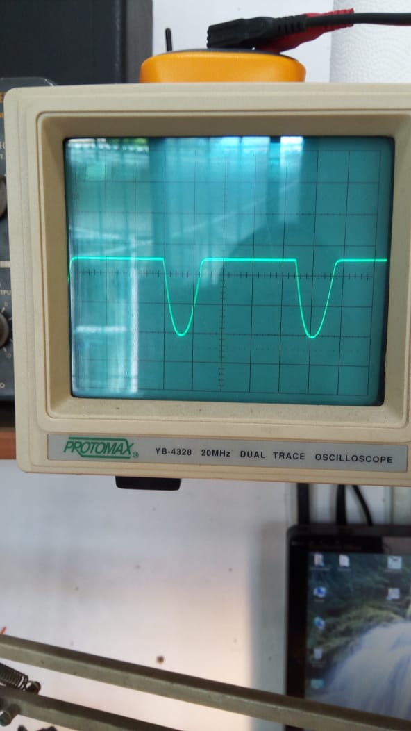

Hi, i'm having same issue that Leandro has. The amp is a Hiwatt Maxwatt G100R with the same power amplifier PCB, with the same circuit. It came to me with a low level and very distorted sound.
When I put the oscilloscope in the speaker output with a 8 ohms dummy load and 1khz sine wave in the fx loop return, I see only a semicicle of the sine wave signal.

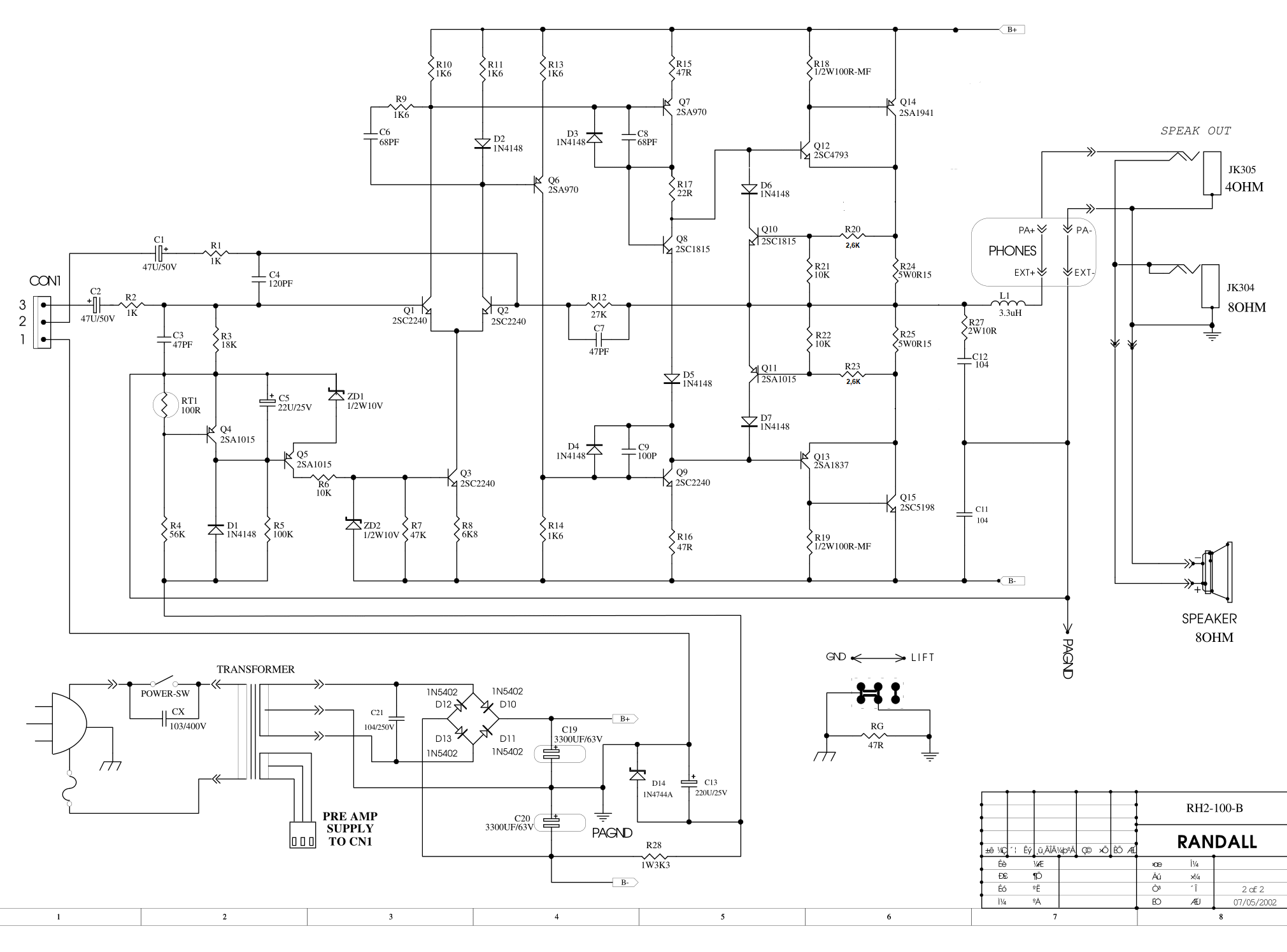

On the Randall RH100; If I am looking at the right schematic (says RH2-100-B in the lower right corner) then pin 1 of the input connector is ground, and pins 2 & 3 are differential inputs. If you short those together you are just feeding the amp a common mode signal and it will have very little or no gain. Unshort them and feed your test audio source into *either* pin 2 or pin 3, not both. [In addition, looking at the schematic, I believe there should be a connection 'dot' at the junction of the low end of R10 and the right end of R9]

This is the issue. I'm feeding 1Khz / 100mv in the Fx loop return. The preamplifier is fine.

Fail - with no signal input, (unplug the cable on Con1) and the amp powered on, what is the DC voltage at the output (either side of L1)? Then measure the DC voltages across R24 & R25 - these should both be very small. Still with no input signal, measure the DC voltage at the base of Q12 and Q13.
looks as if you are only driving the negative half of the amp. if Q10 were shorted or leaky, it could cause the problem shown. assuming the schematic you posted is correct, there are two signal paths in this amp, with the signal path for the negative side beginning with D2 and Q6 acting as a current mirror to drive Q9. the positive half (which is where your signal is disappearing) is Q7, 8, 12, and Q14. check these transistors, and also, check the resistors that go to the +Vcc rail R15, R18. check R17 also. you are likely to find your problem is caused by one of the + side transistors, and/or one of the resistors. check the resistor from Q14 to the speaker output (R24)

you can't trust any voltages you read after powering the amp off. however, with the amp on you should be able to measure and compare the voltages across certain resistors (again, assuming the schematic is somewhat accurate for the amplifier you have) the voltage drop across R18 should be the same as it's "opposite" R19. the same for R15 and R16. R13 and R14 should also match, as well as R11 with R13 (R11 and 13 are part of a current mirror). R17 should have almost the same current through it as R15, so should have approximately 1/2 the voltage drop of R15.
the voltage drop comparisons will most likely indicate where the trouble is. you will likely find one resistor on the positive side that either has full rail voltage across it (meaning it's open circuit), no voltage across it (meaning the transistor it's associated with is open circuit), or vastly different than it's negative-side twin (meaning the associated transistor is leaky, or something else in the nearby circuits are awry) some of the symptoms you mentioned also seem to point to some bad solder connections around Q8, so you might wnt to poke around near Q8 and see if there's any breaks in the solder or in the PCB traces.
it seems there are/were multiple companies using the Hiwatt brand name, the most recent, some chop shop in China that likes using an op amp and 2 current booster transistors as the "power amp". this is probably one of the reasons a schematic is so hard to find, it may have been a knock-off of another amp, and probably so inexpensive that they expected people to replace it rather than get it fixed (which means they don't know much about musicians).
