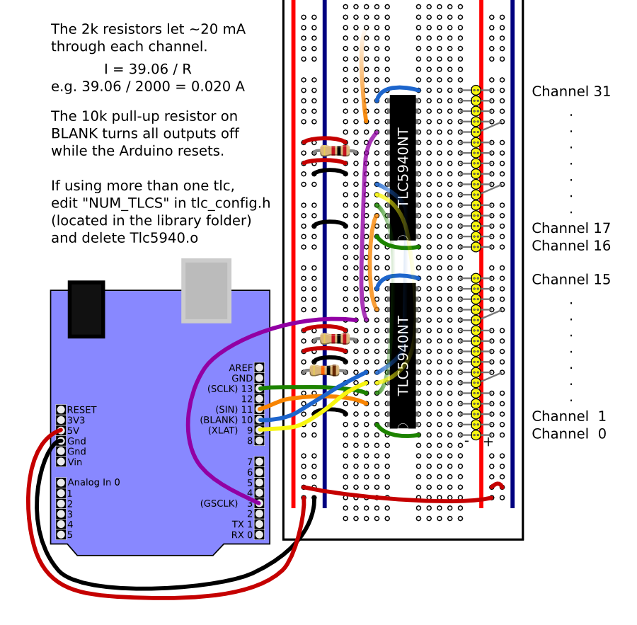

The scope has now changed slightly! I'm using TLC4950's to run the LED's and they sink so I'm going to need a PNP transistor that can switch about 800mA and also one that will handle a few amps. Any suggestions?
For reasons stated above, personally I'd use a P-MOSFET :)
Might be time for a schematic so we can see the whole thing.
real simple at the moment, set up following the example here https://playground.arduino.cc/Learning/TLC5940
I just now need to drive transistors with the ouputs. Is there a way I can use the BC337's that I have?
