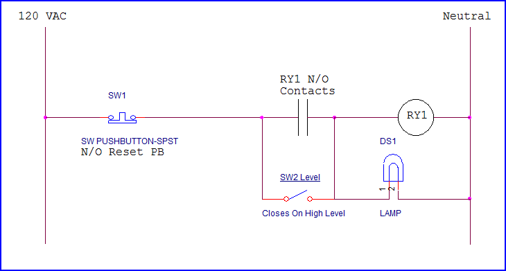

I would really appreciate some help with a simple circuit design.
Here at the park we have a lift station that has a very simple warning light circuit. (See attache file) It's just a normally open mercury float switch that turns on the warning light when there is a high water condition. What it is actually signaling is a failure in the lead pump. If the water continues to rise the backup or lag pump come on and pumps the water out. The problem is that it is quite possible if not probable for the light to go unnoticed during the time from the high water condition and the lag pump coming on.
I need a means or method so that once the water has risen to the point of closing the float switch the warning light remains on until manually reset.

Here is a pretty rough cartoon of what I had in mind earlier:
I would just use an 8 pin octal base plug in relay available from McMaster Carr Supply and dozens of other suppliers. I would buy a DPDT relay just in case I or someone wants to add something later down the road.
Relay McMaster Carr #7170K13 $15
Relay Socket McMaster #7122K19 $5.00
Granted this relay is overkill for a small indicator lamp but it leaves options. That or just get a smaller SPST relay. Either way you come in under $20.
Ron

I have been studying the schematic you posted and I'm wondering....
Shouldn't the reset switch be a N/C push button?
Reloadron
OMG that is absolutely correct. I drew in a N/C and labeled it N/O. Yes, it should be a N/C push button reset.

Hey Tom, my pleasure.
I used Cadence Orcad Capture (A free version) for the drawings. Pryor to retiring I used the full versions of Orcad. The free version works OK. Unfortunately I can't build parts libraries in the free version but again, it is free. :) I also use LtSpice at home for circuit simulations. There are several free schematic making software out there.
Something to keep in mind is the relay I linked to and used in my example is only rated I believe for 7 Amps AC (inductive load). Not a big deal as they can be slaved to other larger relays or motor starters (like big pumps). Spent a good number of years working with some very large and very unusual pumps. Many of which also carried pretty high price tags so I know the drill with pump protection routines. :)
