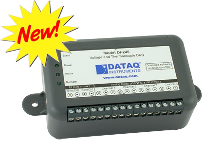

I have a "data acquisition" box. About the size of a deck of playing cards. They connect to a PC via USB or serial. Mine has 32 inputs that measure voltage. It can be set to measure every 1 second or every 5 minutes or 100 times a second etc. The data can be input into a spreadsheet program.
This picture is typical. There is no isolation! They can measure voltage, some measure temperature probes, current etc.

This would go much better with more information as KeepItSimpleStupid mentions. Also, this could likely be done quite easily using any DAQ (Date Acquisition) device which RonSimpson gives a good example of.

Personally if tasked to do this I would use a DAQ like Ron mentions and write some very basic software around it. The data could be dumped into Excel as was mentioned. I likely would not use a shunt but a current transducer be it AC or DC **broken link removed**. The link being only AC examples. Anyway, you will need to provide much more information before anything of value can be suggested.

I know that somewhere around here I have some of the CR Magnetics sensors but don't have a clue where? :) I think both current AC and some voltage transducers. Also a bunch of shunts as well as some CTs. Years ago I got some of the DATAQ Instruments data acquisition units you show. Used a bunch of their stuff over the years. Heck, the early Starter Kits were RS232. I liked DATAQ because they are in Akron, just down the road from me and they give excellent code examples for using their products.
