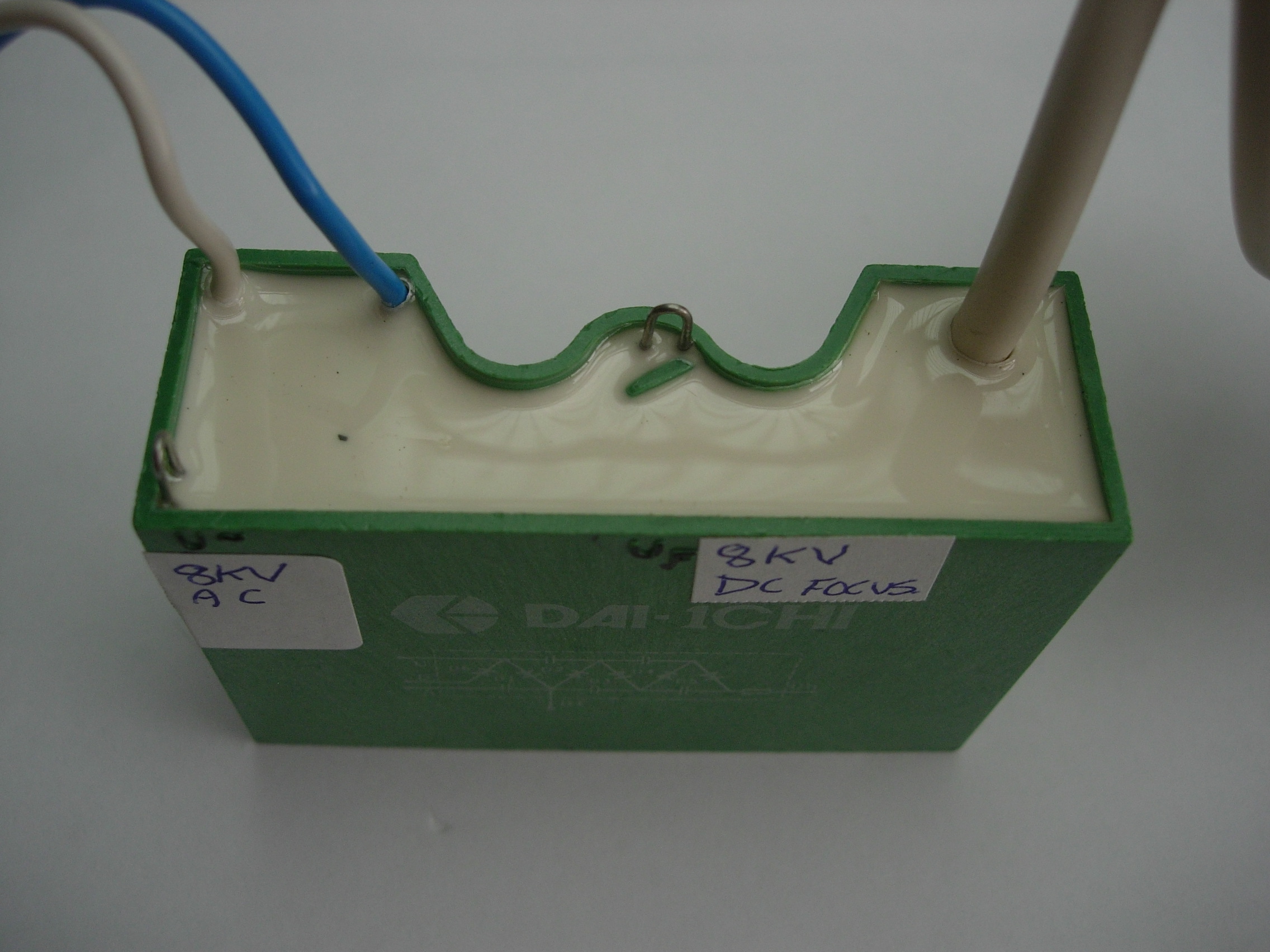

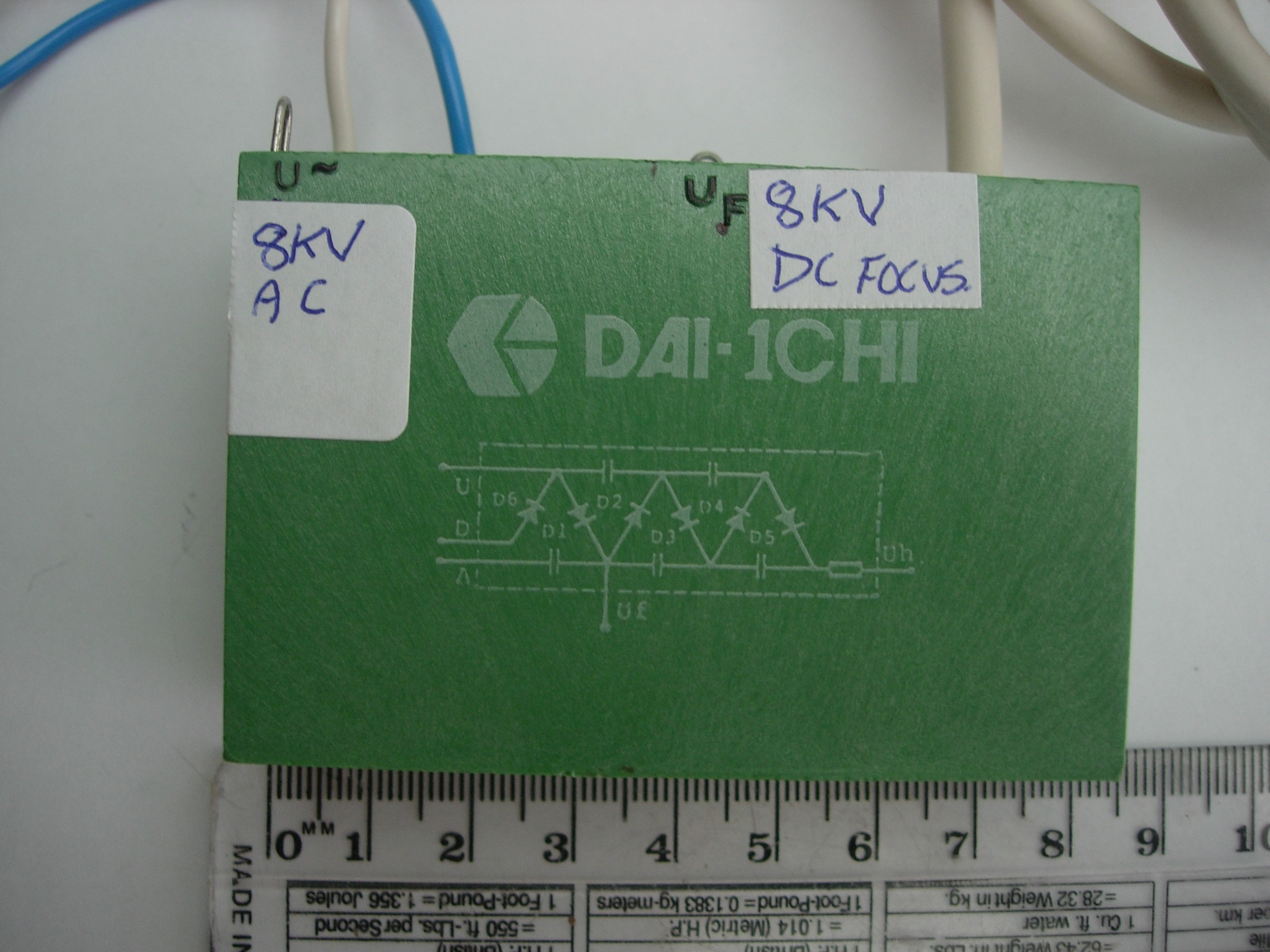

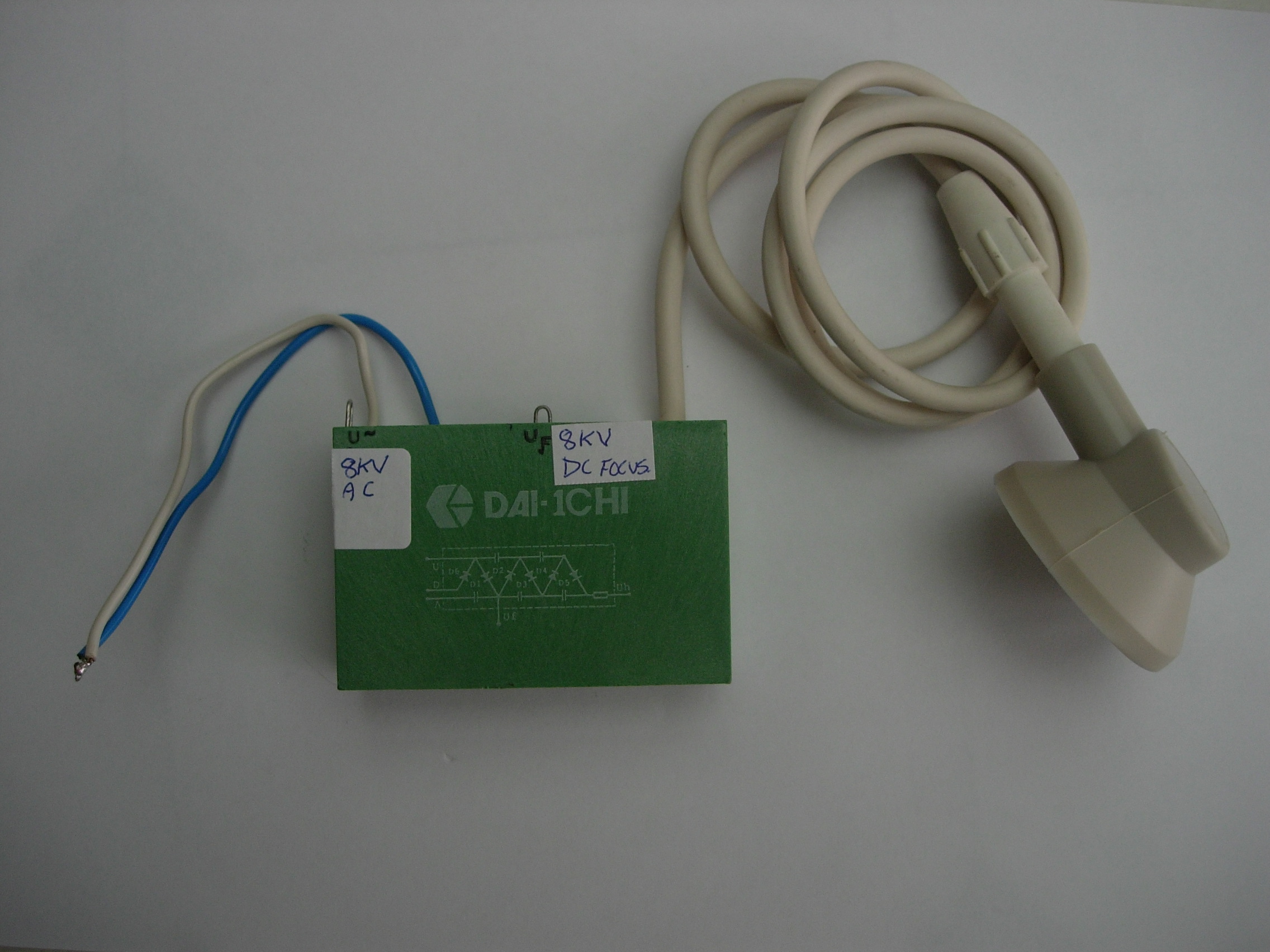

This is a Tripler from early Philips colour TVs (threw my stock out but kept this one for old time sake). These are still available & you feed 8KV ac in & earth the blue & white wires Theres 8KV DC available from Uf & the long lead gives 24KV DC. Be a help if we knew what Brand & model radar we are dealing with here. Most Radars ive worked on use a separate EHT supply in a metal box & its full of a silicone like compound, for obvious reasons in a Marine environment.
