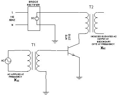

I am repairing a power supply and am reasonably sure I see the problem, but before I replace any parts, I'd like some opinions. I am going to post a simplified schem. of an NTE 2310 npn high V high speed switch in between two transformers. As I read it, T1 induces an AC signal at Xhz through the secondary to the base of the transistor, which switches at Xhz, producing elevated alternating DC through the primary of T2, which induces the same into T2 secondary. I am reading approx 320VDC across the E-C pins of the transisor with a VM, shouldn't I be reading AC? I am also reading voltage on both legs of T2 primary with respect to ground, but no voltage drop across the primary, and no voltage is induced into the T2 secondary. I am suspect of the transistor. Any opinions?

Presumably this is a crude simplified version of the actual circuit?.
I'm puzzled by your 320V DC reading, that's the kind of voltage you get from rectified 230V mains, 110V should be more like 160V - is there a voltage doubler on the incoming supply?. Is this a PC PSU?, they often do that.
It's fairly unusual for the base to be fed from a transformer?, it 'may' be to isolate feedback from the secondary?.
My first thought though, when presented with a dead switchmode supply, where the chopper isn't short circuit - is the startup resistor, almost all SM supplies have one, and they commonly go high or O/C. This prevents the supply starting up, and should be the first thing you look for - be careful though, the large electrolytic will probably be left charged up!.
Look for a large value resistor (usually between 50K - 2.2M), it probably connects to the 320V supply, and feeds the base of the chopper transistor.

I have more information....T1 is signaled via an IC (manufacturer's spec i imagine) labeled HYB9912. This is an older Boschert PSU later produced by Artesyn...model XL125/4602. It is an either/or 110/220 VAC to quad-DC power supply. It came out of a lab instrument manufacured by LECO corp. The issue is, the IC chops the transistor, but the voltage required to power the IC comes off a tap from T2, which is not inducing. It is kind of a loop that isn't working. And, oh yes, the cap is very hot!! hehe. I got that tingly feeling once and started discharging it each time I depower.
BTW, I am reading .6 VDC at the base of the transistor with no measurable AC freq when measured with a freq. counter. There is no voltage whatsoever at the IC. There is no resistor located in series with the base of the transistor. It connects directly to the transformer secondary. I wish I could post the schematic, but all I have is a very fuzzy facsimile version that looks like it is a copy of a copy of a copy. I was very lucky to get it from the tech support of the Leco instruments company. I find it unusual to get schematics from vendors.
Try and find the startup components, as you have a circuit (even though poor) it shouldn't be too hard.
As I said before, usually it's a high value resistor (and high value resistors are well reknowned for going higher or O/C).
The next most common component would be an electrolytic capacitor, these almost always go low ESR (probably the most common failure mode in the 21st century?). It could be used to give a 'kick' to start the PSU, or it could be a decoupler on the supply rail for the IC - a third possibility is a coupling capacitor to the chopper, but not if it uses a transformer!.

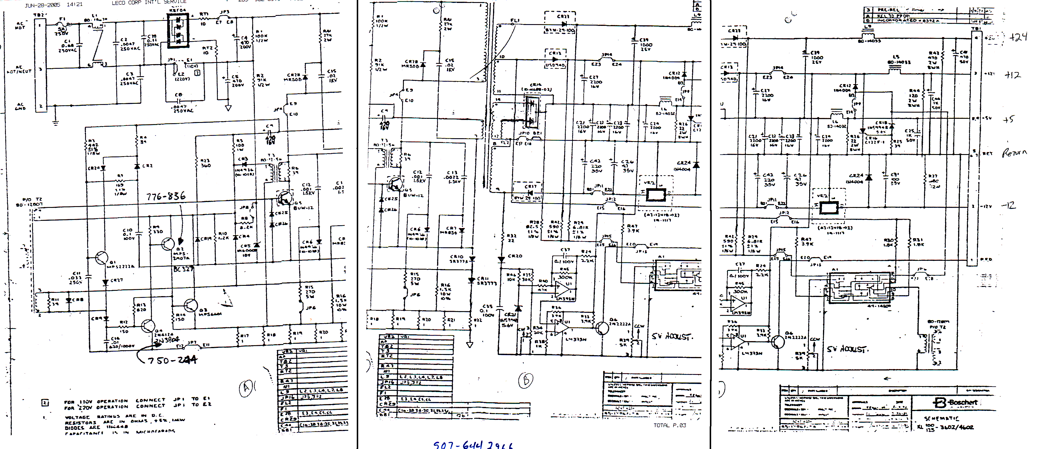

I am going to go home and scan the schematic. It is fuzzy enough as it is, but maybe it could shed some light for Nigel or another more experienced guru than myself.

BY "Very Hot" I meant charged up, not thermally hot. It is a slang expression I use. The capacitors that hold the charge are C12,C13. I have been discharging them each time I depower the circuit. By the way, Nigel. I did in fact already replace R2 because I found it open. This did not fix the problem, but it was in fact open. It is supposed to be 91kohm (fuzzy in scheme.) It was reading infinity on the Megohm scale of my meter. So, by logical deduction, you think C9 is the kick start cap? I will try replacing it and report! thanks.
I replaced C9 and now I have unfiltered AC 56v on the low voltage side of the PSU!! C5 is bulging a little, I'm going to look at replacing it...any other ideas? BTW, the AC is at line frequency of 60hz.

OK, without a shadow of a doubt, Switch Q5 is doing its thing right now. The primary side of the main transformer is working (though incorrectly I think.) The voltage drops as would be expected across T1, and drops even further across the switch. There is definately conduction occuring. I seem to be seeing this when I measure the T1 with my meter. On several taps I read 300+ vdc, with 11 volts of AC...I believe we are narrowing it down to a cap on the primary side. Maybe C4?
