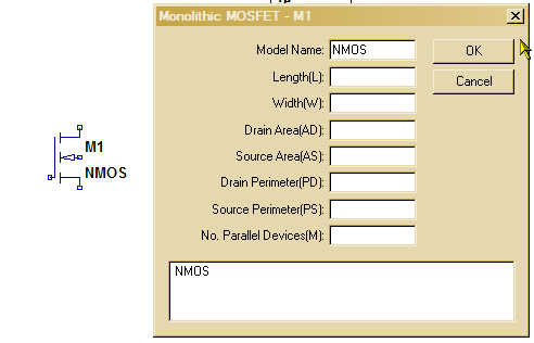

Attached schematic is my proposed Miller op amp design. I have drawn it on LT spice. I used BSIM 3/ NMOSs and PMOSs, But It did not work. I can not get open loop gain and output swing. Do I need to key in gama, Cox, etc? I only keyed in ‘W’ and ‘L’ values for the transistors. If that so where to key in them in LT spice? I know winspice , we can use .txr file to enter values.
Thank you.
Use symbol nmos4 and right click on the symbol to get the parameter entry box.
Please post your LTS 'asc' file when ready.
Why don't you use known MOSFET models from the library.???

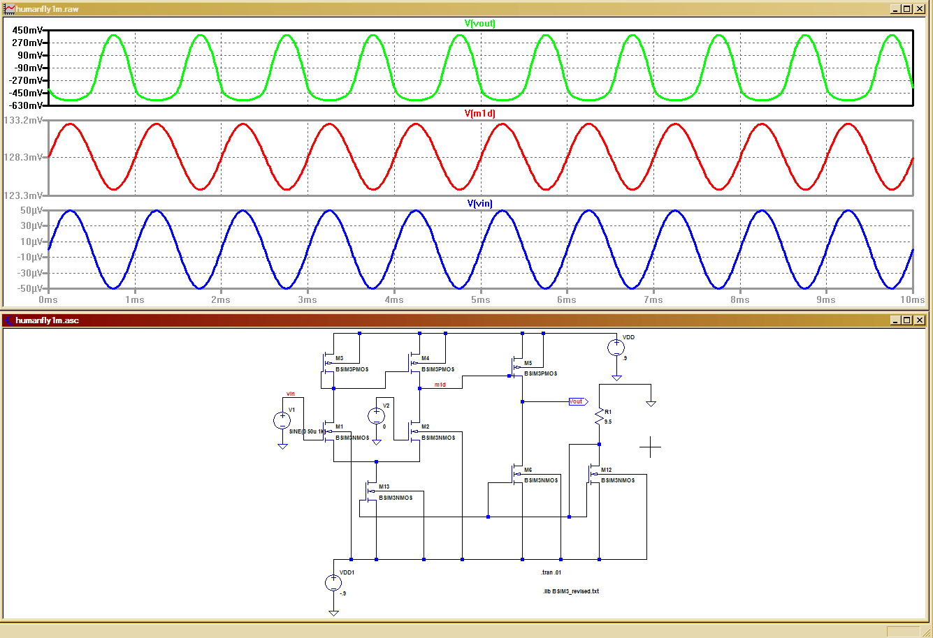

For testing I have modified the V1 and V2 signals
V2 = 0 and
V1 is a 1KHz sine-wave amplitude 1uVpeak to peak , this gives a 'fair' output at Vout of ~777 mVppk
Which is a gain far greater than 10K!
If you now increase the Vin to 100uVppk , the signal at M3 drain is still 'linear' but the output stage is clipping at ~ +/-0.6Vppk
Reducing the Vin to 10uVppk gives a sine wavewave that is just starting to limit.
The output stage M5/6 requires the CC source and biassing to be redesigned.

As requested the modified asc file.
I would suggest the same as you, design the output stage so that it can handle a +/-0.5Vppk swing.
Ideally you want the Vout to be 0V , for 0V input

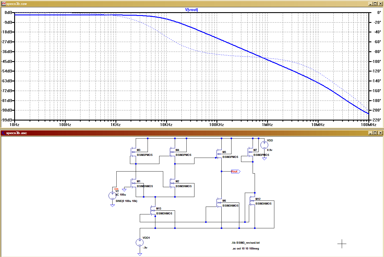

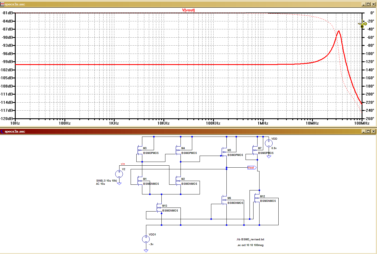

I have modified my circuit as your advice. So I can meet my specification which is gain more than 10k while maintaining Vout 1Volt swing. Please see the specs1.asc file and .doc file. (Please note my Vdd and Vdd1 are +.9 and -0.9)
From that I can go and find my 2nd specification which is to find Acm when both V1 and V2 connected together and do DC sweep. See the Specs2.asc file (Please note my Vdd and Vdd1 are +.9 and -0.9)
Next for specs 3, I should do Transient analysis. See the specs3.asc. I should give 1V p-p sine wave with 1V dc input and get 1v p-p output when the amp in close loop.
My issue is in specs3 I can not use Vdd and Vdd1 are +.9 and -0.9. But is use Vdd and Vdd1 are 0 and 1.8 I can get both input and out put 1v p-p.
Please tell me why I can not use Vdd and Vdd1 are +.9 and -0.9 for specs3? Is my Transient analysis circuit wrong?
Thank you
Look at this option.
  • specs3a.asc
Option 2, very limited BW.!
  • specs3b.asc
