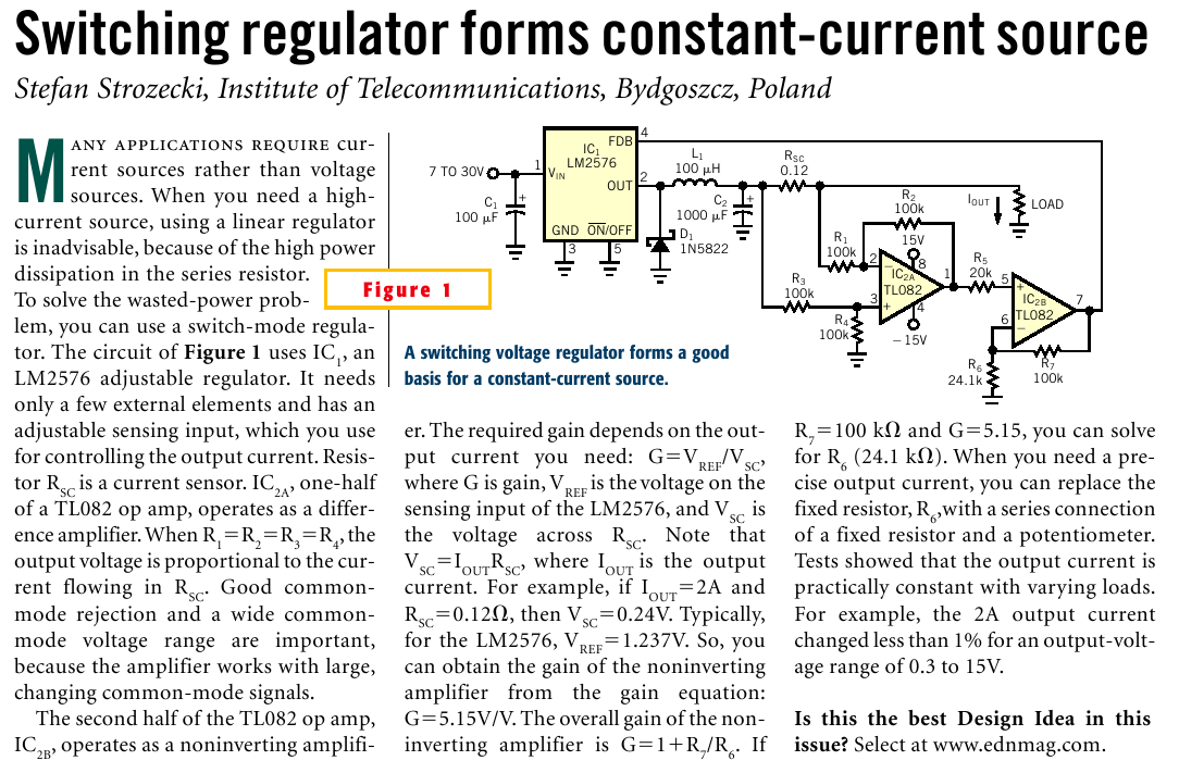

Thanks for the replies, and I took some advice here and I found this:
With a couple of questions...
Lets say I'm using like 2 LEDs in a series with this circuit... can I add more in parallel, or would I have to build the circuit again for more LEDs?
I took some advice here, and did a google, and came across this:
I only have one question...
Can I run some LEDs in parallel on this circuit, or would I have to build the circuit again for however many LEDs I need?
LEDs each have a slightly different forward voltage. So if they are connected in parallel the one with the lowest voltage will hog most or all of the current and burn out. Then the other LED will have all the current and it will also burn out.
Manufactured products have LEDs in parallel because they measure the voltage and sort the LEDs into groups that have the same voltage.
If a regulated current circuit can operate from a higher voltage then LEDs can be connected to it in series then each LED in the series string receives the same current.
Each string needs its own current regulator.
