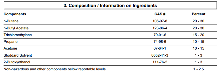

P.S. Do you (John) or others know if the enhancing spray is for sale in Europe or in an American webshop like Mouser or Digikey? Could be nice to make a comparison between spray and whiteboard ink.
Here is the MSDS for Sprayway toner enhancer:
If you can't get a commercial toner enhancer, you might just try acrylic lacquer thinner, if you have a way to spray it.
