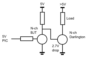

Hi there,
I need some inputs on how to supply a high current from a microcontroller. The setup is a high current darlington transistor (Ic, max=150A, beta=100) and a microcontroller to control it. With the transistor gain I need to supply 1.5 A. Can this be done using either darlington driver arrays or power transiors/MOSFETs without using small-Ohm high power resistors that eats up all the power?

What I'm really asking is what to use and how. I'm preferring the MOSFET/BJT approach, but with e.g. an N-BJT, you need a high-end high-power resistor to the collector of the BJT in order to supply the high current to the base of the power darlington. That I want to avoid - if possible

I want to use power darlingtons to drive to load, because the ones I have in stock can handle the needed 150 A, but unfortunately the gain is only 100, so I need the large base current. My question is therefore if I can use either a MOSFET or a BJT to create that large base current while controlling it logically from a microcontroller? The load of the circuit is inductive.

Of course you can - just use a driver transistor to feed the output one - resistors required depend on your exact circuitry, and on what you're trying to do.
@Nigel: It just that, if the base of the power darlington requires 1.5 A the collector resistor power dissipation will be ~4W, so I just thought that there would be a smarter solution

The circuit could be like the one attached

When switching 150A of inductive load from a PIC, you are crazy if you think that it is ok to share a common ground between the PIC and the power circuit.
I would be looking at an opto-isolator between the pic port and the input of your Darlington booster, with galvanic isolation between the grounds.
Just search these forums for all the "PIC unexpectedly resetting when I switch my load" threads. There are dozens of them....
@MikeMl: I'm using an optocoupler, but didn't include it in the schematic - nice spotted.
But will the low ohm collector resistor really do the job here?
Maybe several P channel Fets in parellel to switch the load, that way you dont need all that base current. Along with an optically isolated N channel Fet to pull down all the gates. Do you really have 5 Volts at 150 Amps ?

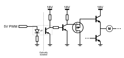

I'm not going to run 150 Amps continuously through the circuit. The high current is simply a possibility, if the load current (in this case a motor) peaks for a shorter period of time. This could be the case at start-up of the motor, or if the motor is temporarily blocked. I'm going to run in the 20 A range at 18 V thus staying below the 700 W range of the component.
@ChrisP58: I haven't measured the load inductance yet, so I cannot determine the optimal switching frequency at the moment. The duty cycle will be very small (not considering that the signal may be inverted), since I need a low angular velocity. I think the no-load velocity of the motor is ~4000 rpm.
@MikeMl: The PIC circuit is 5V, and all interfacing between the control and the motor side will be optically isolated.
@Nigel Goodwin: I'll consider switching to P-channel MOSFETs to control the darlington base in order to avoid power resistors. Instead, the MOSFET can be mounted with a suitable heat sink.
The new circuit attached shows the idea

Yes, I have worked with them before, and I would probably use them instead of the darlingstons in another situation. For now though, I already have a bunch of the high power darlingtons, so I'll try to use them first. I know they can do the job, since they used to drive the motors of a 6-DOF industrial robotic manipulator.
