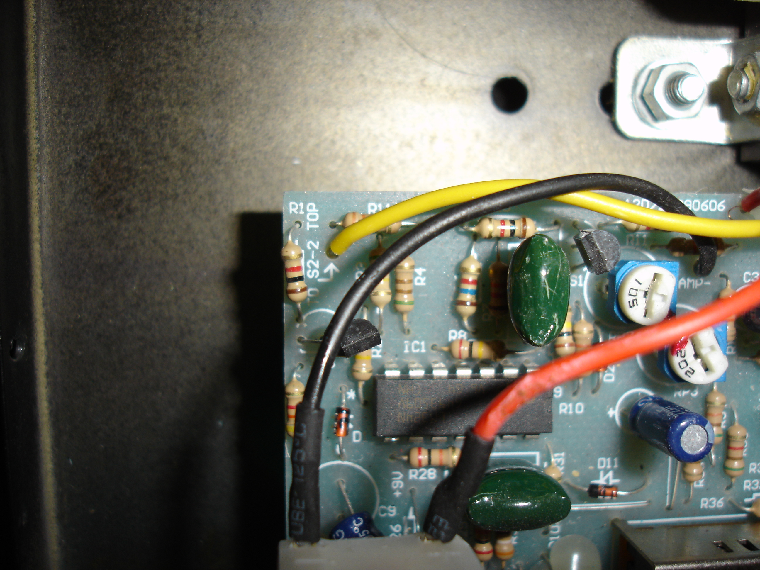

Hi Alec R6 is hiding under the black wire and is 1k6 R18 = 20k R20 = 5k1 R12= 10k had to remove some hot glue to find it you won't see it in the pictures, so it seems only r6 is different surely that would only affect the top circuit?
Ah, my suspicions were well-founded. That would give a total collector load (with the pot at max) of 2.10k. In my sim I needed a total of 2.12k. A pretty good match!! I agree it should only affect the top circuit.
But if R20 is only 5k1 then (according to a revised sim) the bottom circuit (IC2a,b) turns charging on via the FET if the battery voltage is > 2.6V. But even with the FET off there is a current path via R18,R20 to ground. That would account for how you were able to charge a cap from 0V.
About the caps, we've both been assuming they're the main smoothing ones. Possibly the circuit is intended to charge the battery with unsmoothed 100Hz pulses? In which case the caps as shown back-to-back across the AC input to the bridge may be there for spike suppression? Seems an odd arrangement though, and the ripple current through them would be peaking at ~600mA for 220uF caps. Can you trace whether the caps are indeed across the AC side of the bridge?

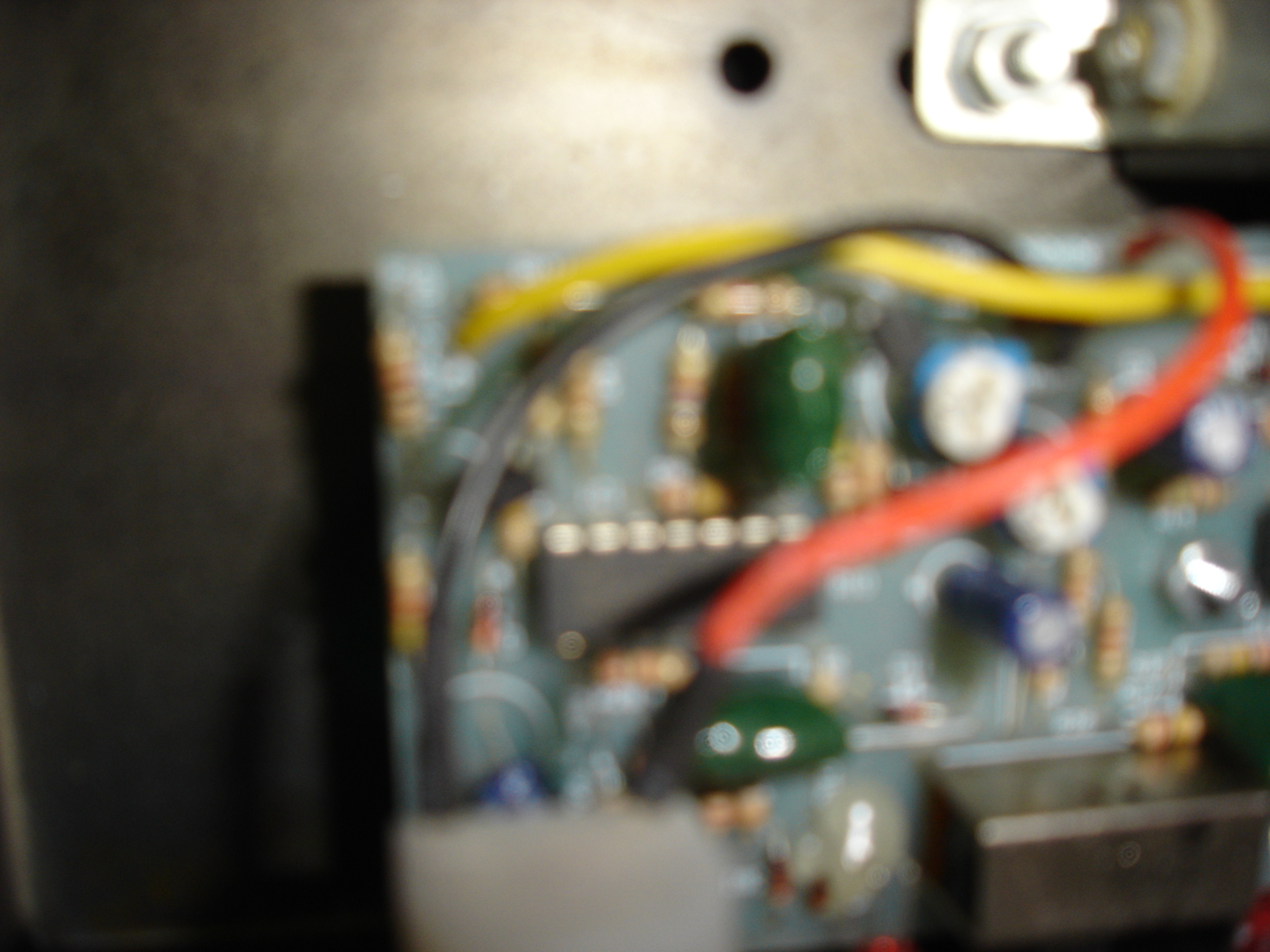

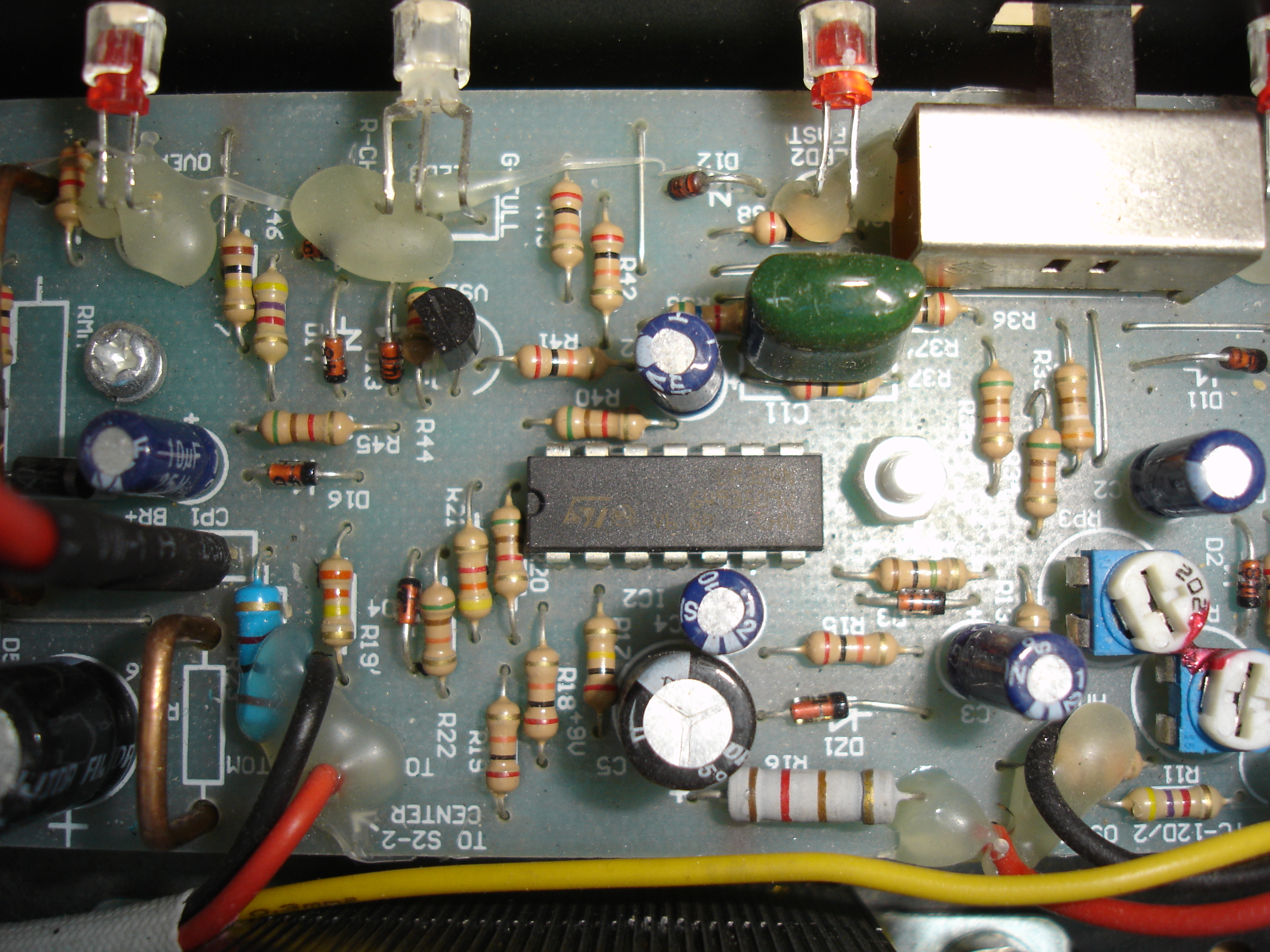

Good morning Alec, Nice one mate :) Yes if you look at the photo of the full board you can see on the right the caps don't exist, what isn't obvious in the same picture is top right where there is a cable tie around the black red and white cables, just to the right of the cable tie, that is the bridge rec, circuit board mounted and bolted to the heatsink. They are nowhere else and I think they just use the battery as a huge capacitor and indeed if you measure the probes you get about 11 volts and then if you put a cap across them it goes up to about 17
Edit: Few more pictures, I moved some hot glue and wires, R12 can be seen now and R6 can be seen next to the green cap top right of the chip.
Strange? I deleted two that were out of focus and the forum shows them as attached thumbnails?

So, there are a few confirmed discrepancies between your actual circuit and its schematic. Doesn't make the circuit analysis easy :D.
