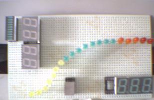

i need to drive:
- 20leds needed 20 outputs
- 2x 2 led segments 24/2 = 28ouputs
- 7x 1 segment 7/3 =21outputs
- 1x led bar (10leds) 10 outputs
i have 1 MCU Pic16F877a (40 pins)
untherstand?? its more that i'm searching for a analog way to switch these things.. or that ever segment only uses 2 of the pic (like control lines) and that another chip does the display/activation of the leds...
hope that everybody untherstands me now better
TKS
Look at the pic..:D

Try using M5451B7, this IC can drive up to 35 leds, has serial input...

The big advantage of using M5451B7 is that it's driving LED's in STATIC mode, and that it has serial input, therefore you can controll it by small 8-pin PIC, and static mode brings you non-blinking pattern.
And it's much easier to implement it than Charlie Plexing, which takes a tone of CPU time...
Hey buddy,have you ever seen how a dot matrix LED panle works?If you ever have,you make use that structure to drive your LEDs.One single MCU can drive up to 512*128 pixles or more,and that's more than 65536 LEDs,which is far more than your requirement.The key that such circuitry would work is the latches.A series of latches connected in serial can extend your I/O resources more than 10 times of the original.Try 74LS595.It's an 8 bit serial-in,parallel-out shift register with output latches.Use an I/O pin of your PIC to switch in serial data synchronized by a serial clock generated by another I/O pin.Each bit will be sent to the cathode of an individual LED while all anodes are conncted to Vcc via resistors.When all bits are shifted out,use a third I/O pin to generate a register clock,and the data bits will be latched onto respective I/O pins.This output won't be modified before next register clock even when you are shifting another stream of serial data into the series of 595s.

TKS,I'm really curious about why you need all kinds of such LEDs lit in one single device.What do you want to display anyway?If you're going to use the segment LEDs to display numbers,in Jay's way,I think it's best to place them in a separate module,that will may table translation routines easier to write.You may use 8 pins of a port to drvie the segment LEDs' cathodes in parallel,and other ports to control other functions,including module selection.
Hey TKS, are you going to put a cover over it or leave it kind of raw like that? I'd be interested to see how it looks when it's lit up in the car.
