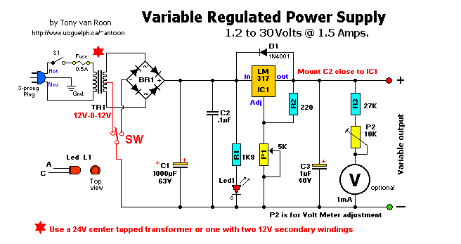

This first thing you should build is a simple 1.25 to 15V power supply using...
What do you think about this one???

That circuit has some issues:
R1 should be 220R and R2 should be 3K.
With just a 1000:mu:F capacitor and a 24V transformer it won't be able to supply 30V at 1A. There will lots of ripple on the output at high currents.
Use a 28V transformer and a 4,700:muF >50V capacitor.
At output voltages lower than about 15V the current will be severely reduced as the regulater's safe area protection circuitry kicks in. There is nothing you can do about this, it's a safety feature of the regulator.

Yes, I did, I was just asking because I was impressed by the 30V. 1A output and the fact that I had already put my mind on it "before" I asked the question here, plus it is available as a kit, so it'd be easier to find the components and see what they look like and the fact that a kit comes with instructions would have made it simpler for a first experience, but now that you tell me he has flaws in his design, I wonder what kind of instructions I would have gotten with that??? LOL.
Thanks for pointing out the design problems and I'll take a "closer" look at the one YOU linked here.
For anyone wanted to build the Van Roon circuit, I offer a simple modification to cut the heat wasted, and increase the current available at low output voltage.
Just use a 12Vx2 Center Tapped transformer instead and add a SPDT toggle switch. The transformer should cost about the same as an untapped one so the additional cost increase is minimal.
Nice mod.
Edit, silly suggestion removed.
It's also possible to get the switch to work automatically.
Just replace the switch with a relay with a transistor and potential divder so the coil is de-energised when the output drops below a certain voltage.
It still really needs to be a higher voltage transformer and a larger capacitor for reliable operation at higher voltages though.
