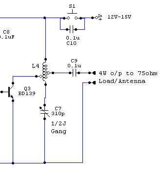

HF final stage matching to antenna
Vaibhav Birit
Has anyone of you seen a final stage to antenna matching configuration as shown below. If yes, can you explain the logic behind it. i.e. how it works..

Vaibhav Birit said:
ok, i got the first point, but how about the second point i.e. impedance matching. How are the calculations done for this particular configuration. Also how do we find the output impedance of the final Transistor.
The data sheets for most r.f. power transistors will show the transistor's output impedance across the range of frequencies for which they are designed. They will be plotted on a special graph called a Smith chart. (Search for tutorials in Google.)
A good book which deals with matching is RF Circuit Design -- by Christopher Bowick.
