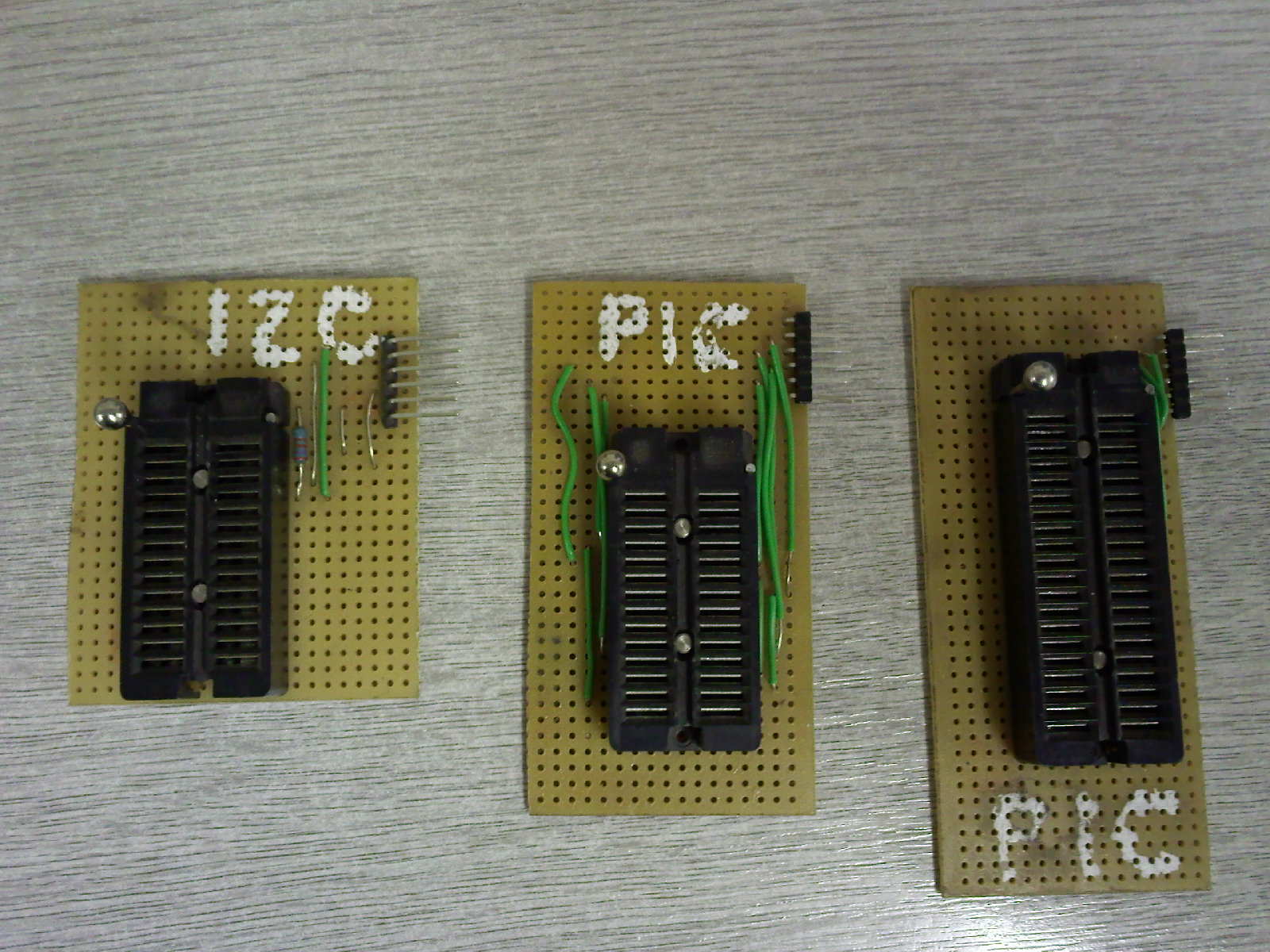

Can you show me how you're connecting the PIC12F679 to the pickit2!! I use PIC12F675's all the time and this program you have written won't give a flying *** about the oscal value.. so it seems the problem here is pickit2 doesn't see the pic chip properly... I had to make three different programming boards to take (most) of the pic range..
Cheers Ian
P.S the middle board takes 8 pin at the bottom and 18 / 20 pin at the top
