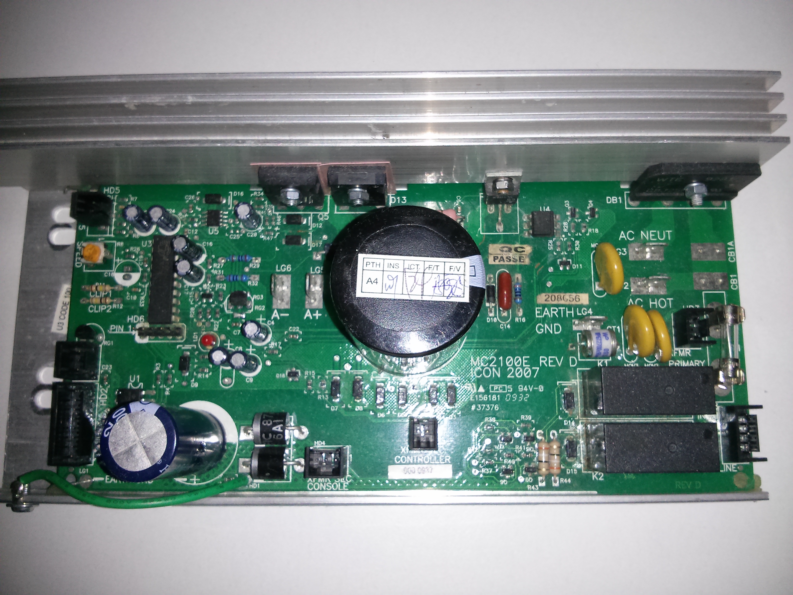

Hi guys, this is the last throw of the dice before I cut my losses and scrap it, I really want to get it going though as it has hardly done any miles.
I have a Nordictrack t9si that started malfunctioning. Long story short I have recently replaced the control board and then the motor. It was initially losing speed after a few minutes of use then stopping but now, since moving it inside the house from the garage as I suspected damp was an issue, it blows the 13A fuse in the plug as soon as the motor is engaged. It is also doing the following:
If I disconnect the (brand new) motor the single LED goes from continuously on when powered up (as it should) to continuously off when speed is turned on (it should blink). The LED will come on again after I either disconnect and reconnect the power cord or wait approx 60 seconds. The incline motor works fine even when LED is off. If I press start or speed up with the motor connected the fuse blows immediately.
I have used a multi meter to see what the PCB is outputting and it seems to send a large amount of power out that gradually dwindles down to zero even if I increase the speed on the control panel.

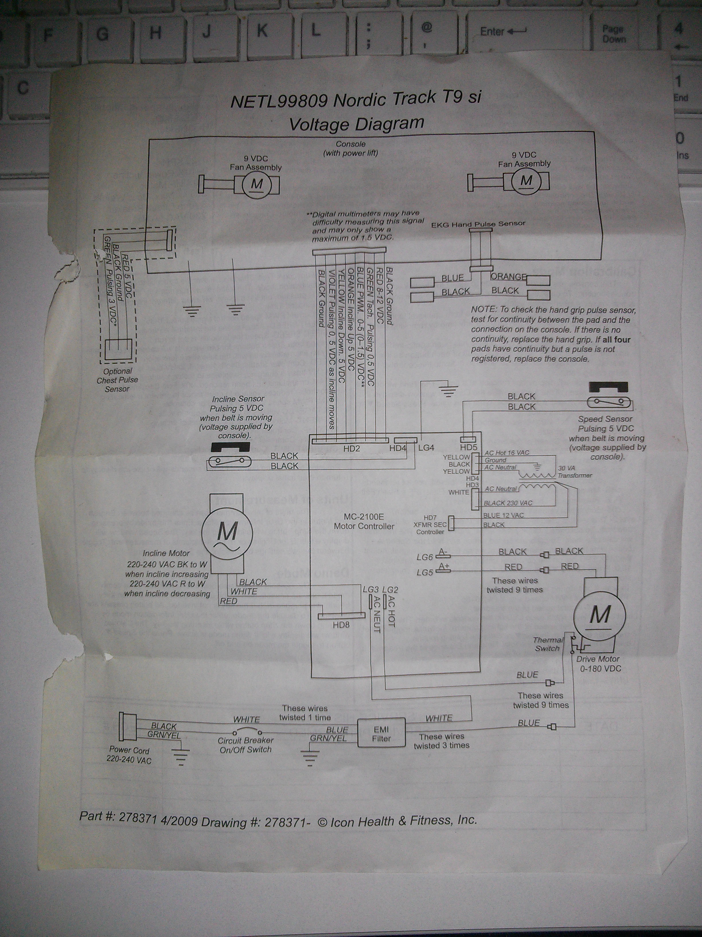

I have a voltage diagram that I could show if anyone thinks they may be able to help. I am (relatively) inexperienced at electronics but usually am able to muddle through using online advice/resources but this one has me stumped.

...I have a voltage diagram that I could show if anyone thinks they may be able to help. ...I would appreciate any advice or help greatly. ...
First of all, Welcome, Jbomb!
Don't know for sure what a "voltage diagram" may show us, but it's a starting point so, yes, please post the diagram. A full schematic would be much better but I have a sneaking suspicion that no such beast exists.

Hi, thanks for the reply. IMG_20140219_185455.jpgIMG_20140219_185419.jpgThe said diagram and also the offending control board (the old one) the new one is fitted to the treadmill but with the exact same symptoms. I'm guessing as I have not been able to find a problem with the wiring that the faulty motor has kaputted both boards? Any help is greatly appreciated as I have pulled almost all of my hair out over this.
The MC2100 (various revisions) motor controller is used is an variety of tread mills and is a favorite as a controller for all sorts of alternate uses: lathe motors, fans, you name it.

There's an LED that should blink when the board is powered: does it?

Hi, thanks for the reply and info. I am starting to feel slightly less nihilistic about this whole sorry episode. To answer your question: There is an LED that comes on and stays on when powered up. It was my understanding that it should then blink when the motor is engaged (it says this on the rear of the voltage diagram). However, it goes out and remains off when the motor is disconnected and I press 'start'. If the motor is connected it seems to send a big surge to the motor and the fuse in the plug blows.

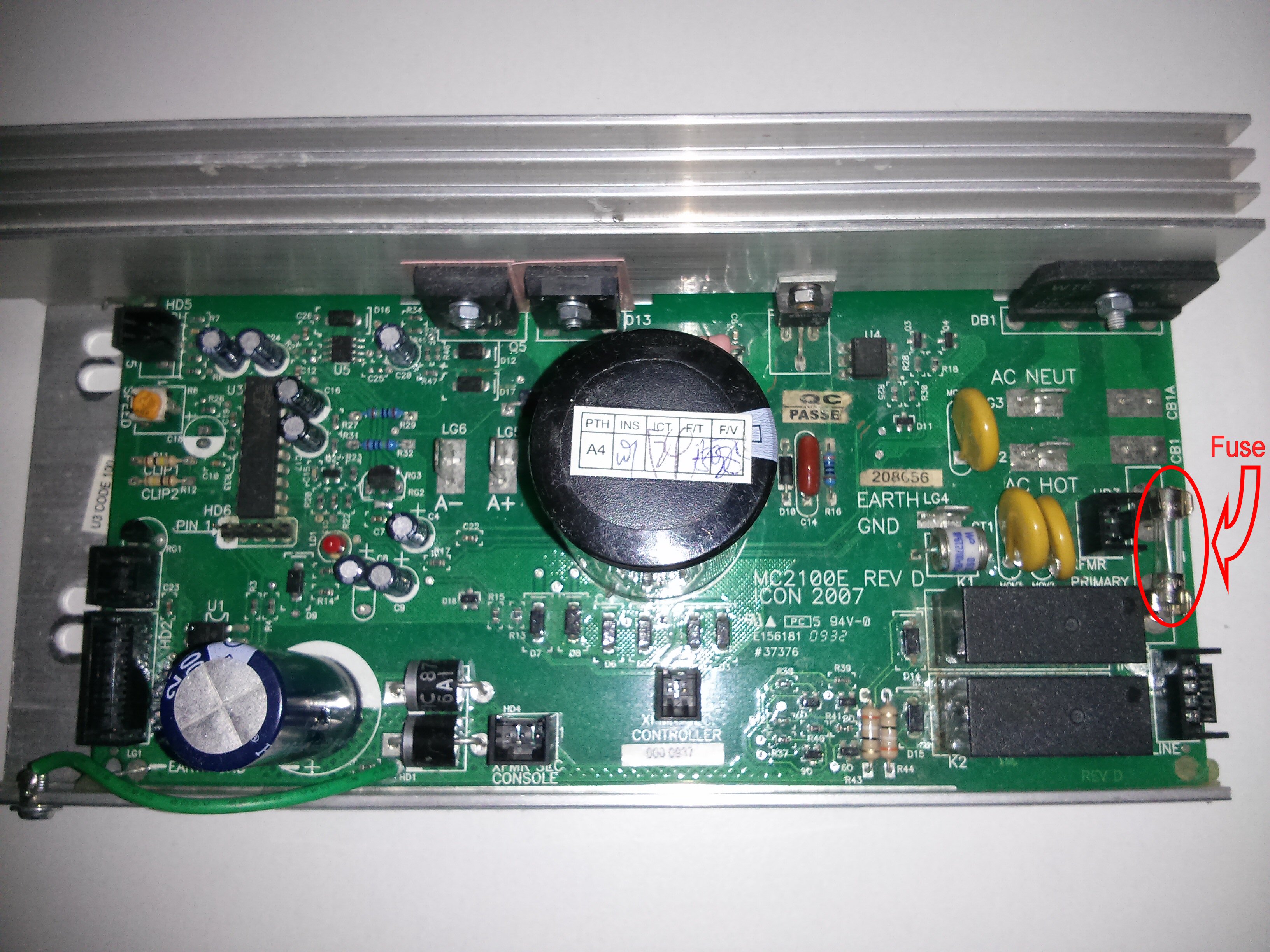

Does your PCB have this fuse? (there is no fuse shown anywhere on the schematic. Not too surprising since it's a reverse-engineered job ["REV B", I think] and this is a "REV D" board).
If so, what is its condition?
Does your PCB have this fuse? (there is no fuse shown anywhere on the schematic. Not too surprising since it's a reverse-engineered job ["REV B", I think] and this is a "REV D" board).View attachment 84441
Yes, it has that fuse and it appears to be in perfect condition. It is the 13A fuse in the plug of the kettle lead (tried 2 different leads) that keeps blowing.

Happy New Year!!! I know these boards from Icon very well, I´ve repaired a lot of them (MC2100E, MC2100ELS). Usually the motor is the main problem (leakage problems and excess of current demand) and it damage the controller. Sometimes some components are damaged and sometimes even the microcontroller is damaged but I also have the option to replace it by a compatible programmed one.
If the LED is not blinking when you go to START from console is because the processor detects a shortcircuit and protects it self. The PWM signal from console is optoisolated from the controller. I would say 100% the old motor damaged the old and the new controllers...
