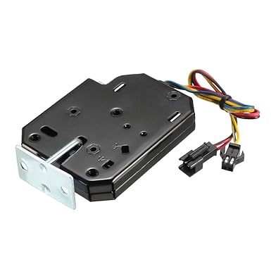

I would suggest this type of latch.
It draws no power when holding. It will release with a pulse of less than a second.

so have got the latch now also tried to get a 24hr timer could do with a mechanicel time with a switch
but only need something to give the lock a pulse to open it,
any ideas what i could use for the timer
