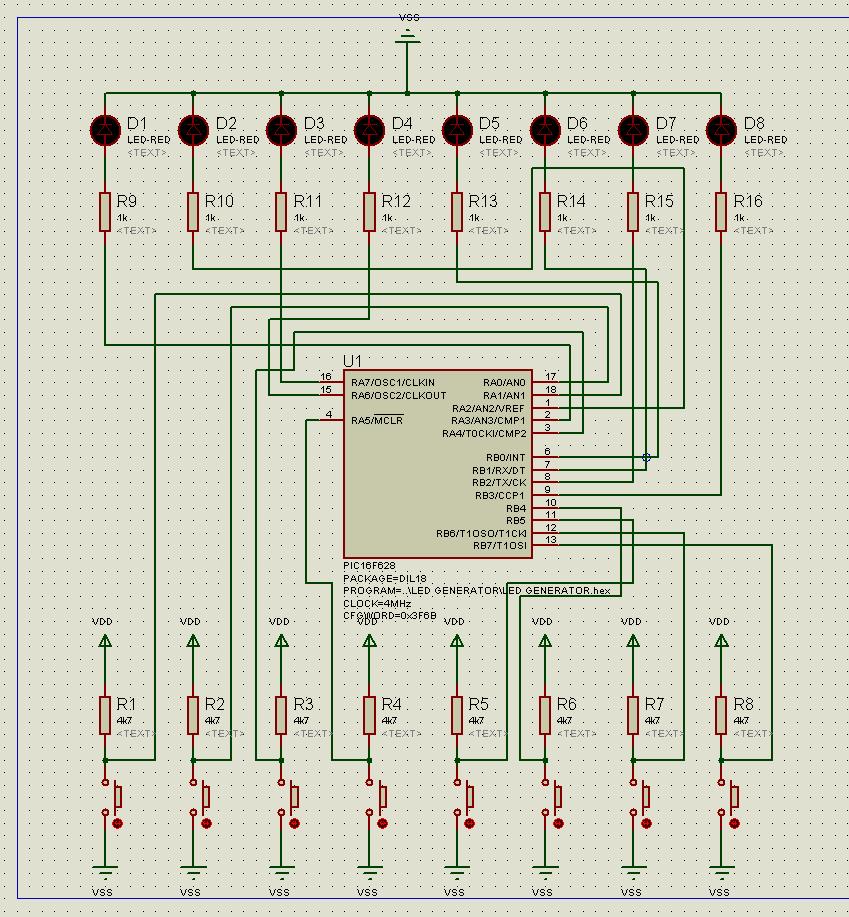

I m begginer i need help.
I need to LED lights turn on and turn off after pressing the button. This means that a push button and LED is turned on first A push button and switches off LED1. This is necessary for all LED and buttons.
program LED_GENERATOR
' Declarations section
symbol LED1 = PORTA.3
symbol SWT1 = PORTA.1
symbol LED2 = PORTA.2
symbol SWT2 = PORTA.0
symbol LED3 = PORTA.7
symbol SWT3 = PORTA.4
symbol LED4 = PORTA.6
symbol SWT4 = PORTA.5
symbol LED5 = PORTB.0
symbol SWT5 = PORTB.5
symbol LED6 = PORTB.1
symbol SWT6 = PORTB.4
symbol LED7 = PORTB.2
symbol SWT7 = PORTB.6
symbol LED8 = PORTB.3
symbol SWT8 = PORTB.7
main:
TRISA = %00110011
PORTA = %00000000
TRISB = %11110000
PORTB = %00000000
' Main program
cmcon =%00000111 'Comparators Off
vrcon =%00000000
intcon =%00000000
loop:
if SWT1 = 0 And (LED1 = 1)then LED1 = 0
end if
if (SWT2 = 0 ) And (LED2 = 0)then LED2 = 1
end if
if (SWT3 = 0 ) And (LED3 = 0)then LED3 = 1
end if
if (SWT4 = 0 ) And (LED4 = 0)then LED4 = 1
end if
if (SWT5 = 0 ) And (LED5 = 0)then LED5 = 1
end if
if (SWT6 = 0 ) And (LED6 = 0)then LED6 = 1
end if
if (SWT7 = 0 ) And (LED7 = 0)then LED7 = 1
end if
if (SWT8 = 0 ) And (LED8 = 0)then LED8 = 1
end if
goto loop
end.

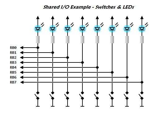

You could use a switch state latch and parallel switch state logic to detect the "new press" state while ignoring the other switch states (no more waiting for a switch to be released). Then toggle flag bits (from on-to-off or from off-to-on) for each "new press" state.
The example below shows this toggle switch emulation using eight I/O pins for both switches and LEDs;
Regards...
; /*  Lighted Push Button Switches (emulated toggle switches)
;  *  swnew  ____---____-----___    sample active lo switches
;  *  swold  _____---____-----__    switch state latch
;  *  delta  ____-__-___-____-__    changes, press or release
;  *  newhi  ____-______-_______    filter out 'release' bits
;  *  flags  _____-------_____--    toggle flag bits for main
;  *  trisb  -----_______-----__    toggle tris bits for LEDs
;     while(1)
;     { delay_ms(25);            // 25 msec sample intervals
;       trisb = 0xFF;            // set PORTB to inputs
;       swnew = ~portb;          // sample active lo switches
;       swnew ^= swold;          // changes, press or release
;       swold ^= swnew;          // update switch state latch
;       swnew &= swold;          // filter out 'release' bits
;       flags ^= swnew;          // toggle flags bits for main
;       portb = 0;               // keep PORTB latch bits = '0'
;       trisb ^= flags;          // light only "active" LEDs
