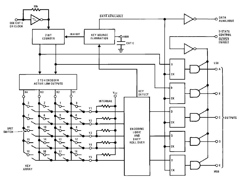

A aaronbaker33 New Member Jun 2, 2010 #1 hi all!!! i was reading through the forums and found this https://www.electro-tech-online.com/attachments/switchbanka-png.33237/ i was wondering if anyone could help me redesign this circuit for only 8 switches instead of 12. im working on a switching system for my guitar pedals and this would be perfect. any help is appreciated. thanks aaron baker

M mneary New Member Jun 3, 2010 #2 Just remove S9, 10, 11, and 12. Of course, Y8, 9, 10, and 11 won't work any more.

M mneary New Member Jun 3, 2010 #4 Of course you could leave S9 thru S12 in and just don't press them.
A aaronbaker33 New Member Jun 3, 2010 #5 what kind of switches would be best. im not exactly sure how it will work since i need 8 stomp switches on the floor....

Boncuk New Member Jun 4, 2010 #6 I'm missing the Y-inputs connected to complete rows of keys. Please compare with the datasheet. Boncuk Attachments 74C922.gif 20.8 KB · Views: 391

A aaronbaker33 New Member Jun 6, 2010 #7 i mean would i use spst, spdt, dpst, dpdt etc type stomp switches
